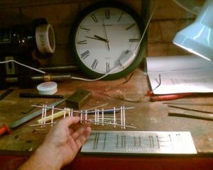

I just made my first set of points, started about 5:45 pm today and was finished by 7:00pm, thats with cutting the sleepers out of PCB board myself.
It took me longer to make the sleeper jig than to do the points!!!

The first thig I saw was all the "machinery", which prompts the question,
"did you bring one for everybody?" :mrgreen: :mrgreen: :mrgreen:
The jig looks like it will do the job! :cool: The shay, and the dump cars didn't escape my attention. Looks like you have the best of most worlds there, again, :cool:

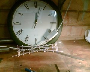

crossing
Just knocked up a 14 degree crossing, made one last night but not happy with it so unsoldered this morning and started again.
Things I learnt...always use your rail gauge to check rail spacing and flange ways on each piece of track before and after you solder it in!!!!
Crossings are REALLY FIDDLEY have to fit each bit in, will be better next one
Conrad, that crossing looks great. But, I thought the fasttrack jigs held the rail in gauge during assembly. Were you just checking or did you have problems with the jig? I ask because I have been considering buying one of there jigs for turnouts.

Hi Nomad
Yes Fastracks holds gauge when you use the track its built for, my rails are too wide on the base, but they are cheap.
So I just run a file down each side a few times until it fits in the groove and I check before soldering.

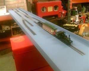

Just spent a few hours putting my points and crossings down on a board.
Its 8 foot long 1 foot wide, what fits comfortably above my bench.
The domestic goddess doesnt know it yet but an 8 foot by 4 foot will be next, but that will take a lot of chocolates and flowers.
Its based on a layout from "The model railway Design Manual" by C J Freezerlayout 3 "Widdecombe" but I will be installing another two points to give a run around loop for the loco.
