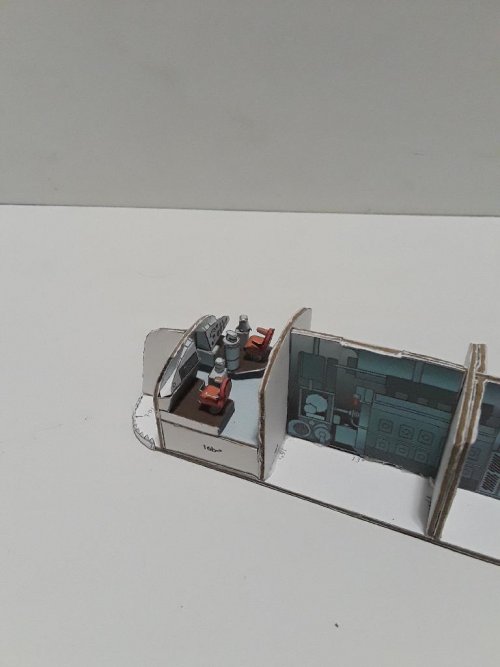

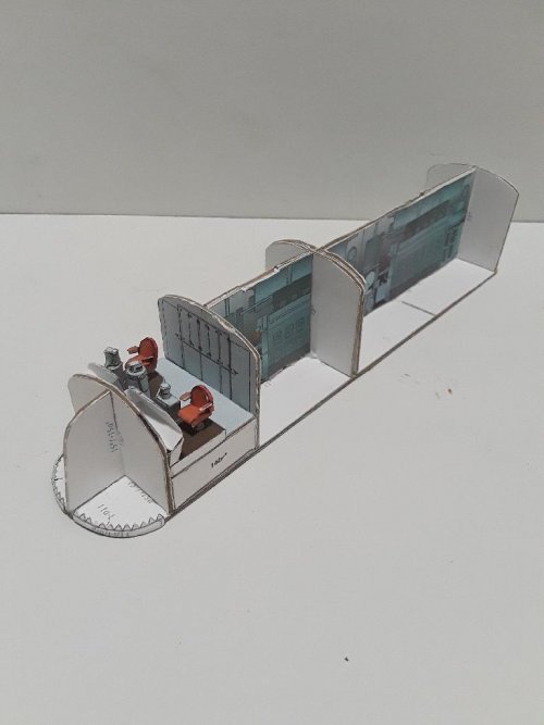

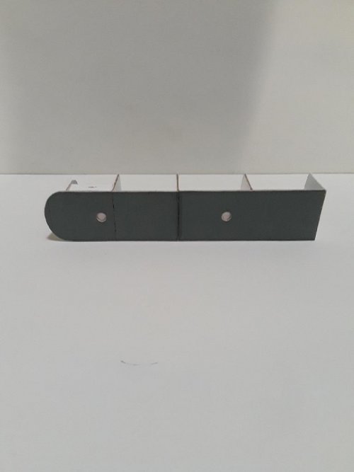

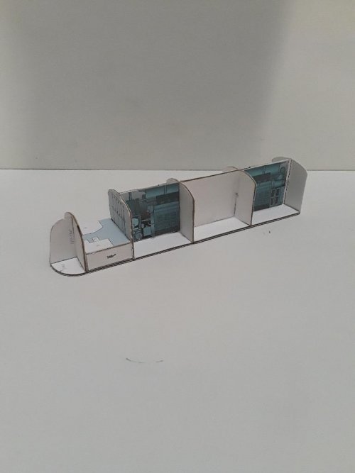

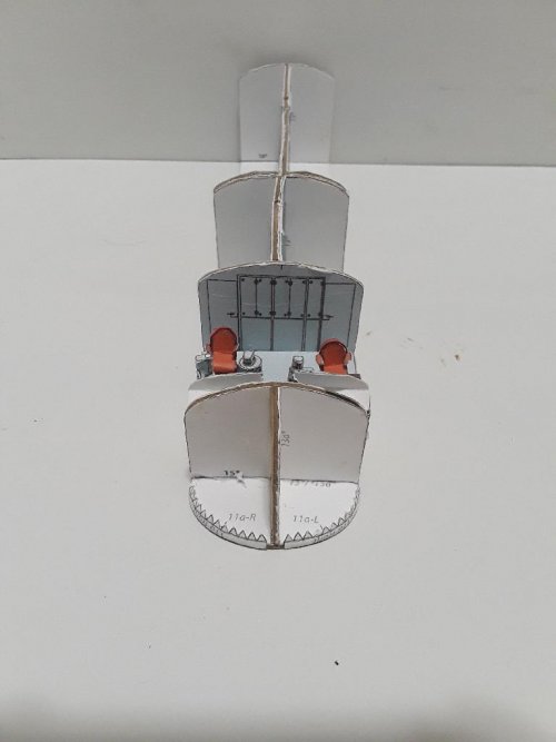

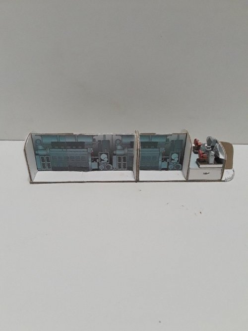

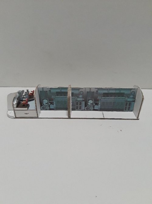

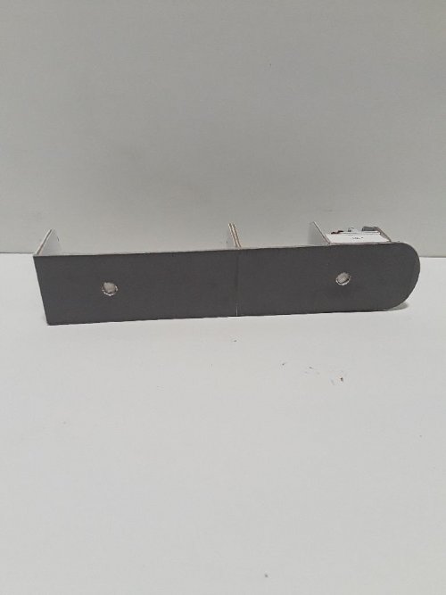

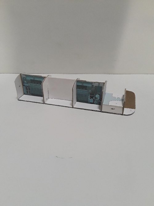

Update: I ran into some problems with the build and parts that required me to make some alterations. First... the base was 3 pieces, and I installed the rear one backwards (instruction shows the hole is in the center, but on the part it is closer to the end). Second... the body formers are in the wrong place. If you cut out the windows in the side of the body, one of the formers shows in the middle of it. Below is the reworked part, as well as the control room?/cockpit.

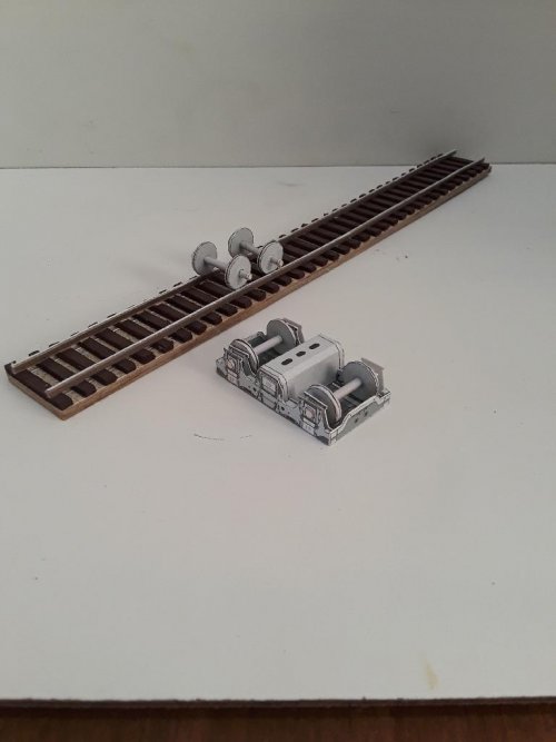

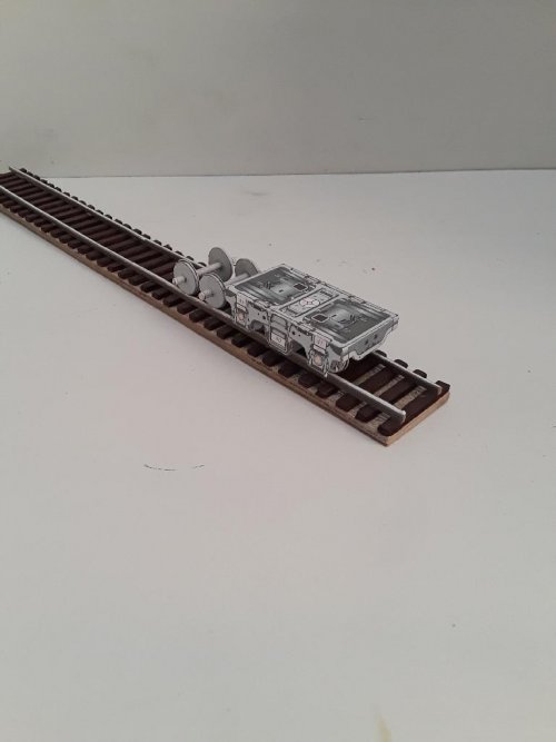

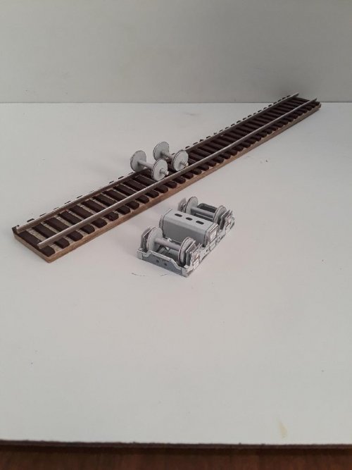

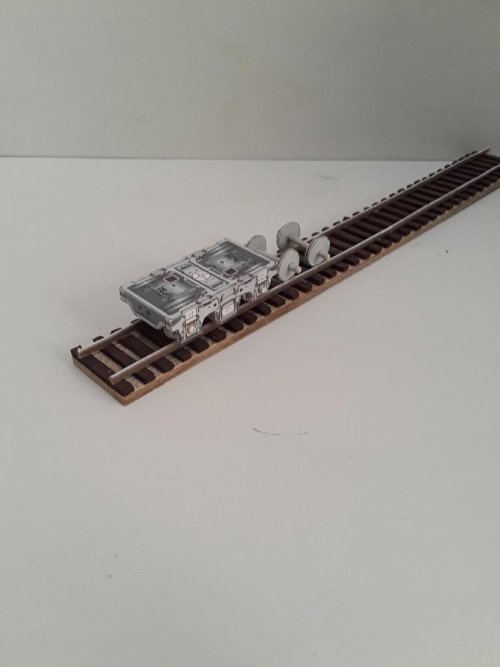

Update: I got a little more done. I did a section of track all the road wheels and started on one of the trucks. It has taken a while, my big hands make it hard sometimes to make and maneuver small parts.
