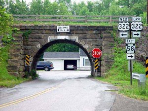

Build your own!
Ideally, you want to build a stone arch bridge that supports a fully-ballasted roadbed and track above it, like this one:
