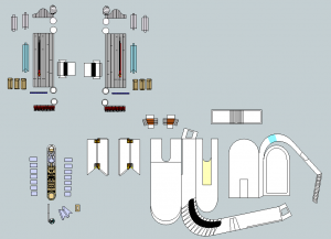

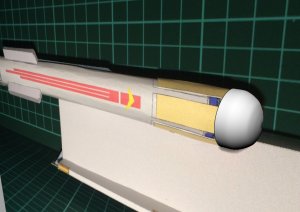

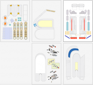

I think the Domes of the Bussard Collectors are best done with conical rings. Give me a diameter, and profile curve, as long as I have a picture that has the diameter's stated size, just draw the profile curve of the dome, and I can whip you up a set of conical rings. It is really easy to do, if the model is of a decent size., and yours looks big enough. Give me the diameter of the Base of the dome, and I will bang out some conical rings. You could use these if you scale them to your needs. :)
