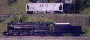

I need to work on my passenger equipment, BTW last night I extended the coal boards on my mike, figured why not since its not painted yet (waiting on a headlight casting) I will try to take some more pics.

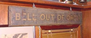

I see you also added an Elesco. Is that the Detail Associates one? I see you've discovered CDS Lettering too. When I was out in your area, I was very disapointed to find very few Erie tracks and very few structures. When we visited Mantua, the guy there was happy that we were so interested in his station. He gave me a very old 3 foot long wooden sign that reads "Bell out of order". I am 99.9% sure that this was an original Erie relic from the 1910 era. Only the railroads would make a sign that would tell you that the bell was out of order insyead of fixing the bell! Leavittsburg was just a field when I was there. There was a building in Warren, wasn't sure if it was Erie or B&O.

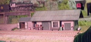

Another thing about that Berkshire. If you switch the traction tired wheesets out so that both are on the rear axle and then replace each original tire with 2 Kato tires, the loco will pull much better. What station was the one you built? Looks like Thompson PA. Came out great. I scratch built a station loosly based on an Erie station.

Yeah thats a detail asso. water heater and pump. I filed the ends off the heater and made new one out of round pastic rod. Detail parts are so crude sometimes. I put the airpump on the pilot and made a brass shroud for it too.
CDS lettering is great, but hard to line up sometimes. I have a few cars with only one "good" side:rolleyes: speaking of decals I just ordered 55 erie sets from northeast. Have you ever used them? They have a caboose set! They are out of business, but the daughter still has all the old stock. Her name is Susan Welcome and Her E-mail is : swelcome@ohdela.schoolone.com I just herd back from her today and ordered.
BTW so sorry everyone about my pic quality :( I have a very cheep digital camera (no auto focus)

Well, I have been to Thompson, PA and that is the only station left on that line. I have it photographicly saved in the old brain pan. I too made the brass shield for the air pump but I scratchbuilt the Elesco stuff. Make sure you spray those decals with either Microscal Liquid Decal Film of Microscale Gloss before you use them. They are VERY thin and fragile. I hope you didn't get any of the RS / GP sets. They just fell apart in the water even after gloss coating them. When I did get a set that finally came off the backing alright, they were so translucent that they looked green on the loco. I had to double decal the loco and when I was finally done, I had used 7 sets of decals! When I wrote to the owner of NE he replied with a very nasty letter explaining to me that his decals were the best and that I had no apparent painting or decaling skills. I threw out all of the remaining decals and switched to Microscale. I have heard of other people having the same response. Hmm, wonder why he went out of business? If you have trouble with dry transfers, try applying them to clear decal film, then brush on some Microscale liquid decal film. They will then apply just like decals. Also, you can go to this military modeling dry transfer company's website. Click on APPLICATION TIPS. They really helped me when I started using transfers.

Hey thanks for the good words. If I had a better camera, I'm sure I would have some great pics for ya.
