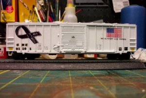

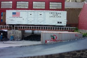

This might give you some ideas.
Here's a couple of boxcars I did. The decals were done on my computer.
The POW car was inspired by the American Chopper POW Bike.

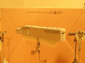

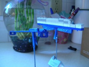

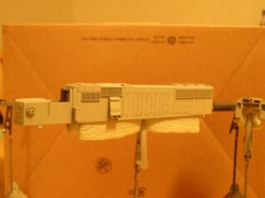

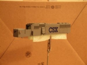

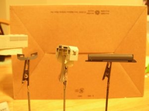

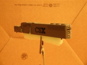

Update:
Final primed the shell (Light Aircraft Gray) and hit the undercarriage/fueltank and plow with Titanium metalizer...so far so good...
Before & After Pics

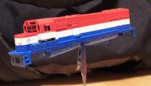

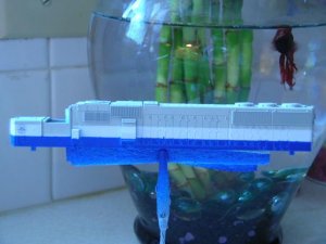

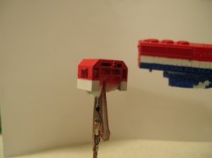

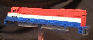

Got the Blue and White stripes on the shell (The white is Krylon's Interior/Exterior Flat White -- Highly Recommended). Still needs a little touch up at this point.

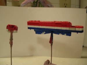

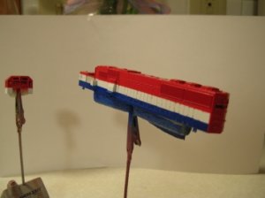

Here we are -- Red, White, and Blue!
Still need to touch up the white -- but all is well and making progress

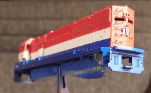

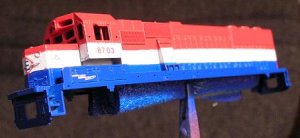

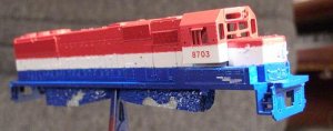

Update--
Got the majority of the decals on -- all that's left are the the red lettered "Erie Lackawanna" that has to go down the side. That's gonna have to wait until I get a new set of decals :cry: (I used the red letters on a EL box car I customed a few years back, never thinking I might be needing them for something like this)
Anyway -- the latest pics:
