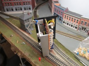

Then I went up to the RR room and installed the two 6 position rotary switches I wired up last night in the control panel.
As a bonus, behind my control panel, I found another 6 position rotary switch, Wish I had found two, but one is better than none, I. Can have Sanders ridge and Gegokayoosa on the same block, and have one huge block for the narrow gauge up the eastern ceiling, and up the top of the central peninsula .

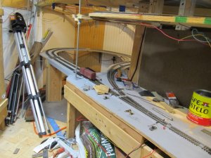

here is the completed main and passing siding at the logg camp, and the partially done roadbed and subroadbed for the 3 sidings for the camp.
this is the end of the lower level of the peninsula, here likewise the main and passing siding is in, with some roadbed and track work needed on the four sidings.
This is the far end of the Montgomery furnace block, and the reconfigured Cave Cove Creek bridge.

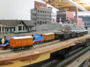

Thomas is visiting Downtown Harlow.
Have been working a little on the courthouse square area.

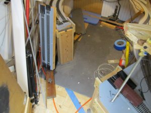

a more in focus picture of the return loop in the bottom of the helix nook
a lift out allows access into the helix nook
with the lift out out
the joint, the atlas re railer is cut in the middle, the end on the lift out spans the gap, so the rail gap, and the lift out gap are not in exactly the same place.
the view from inside the helix nook.
it looks like I built some super smooth curves, I'm working on wiring this stuff up, hope it operates as well as it looks.

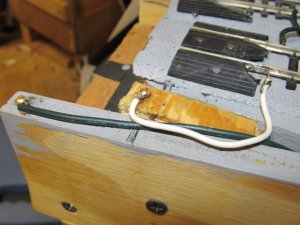

I screwed round head brass screws into the benchwork, to use as contacts for the lift out. and then soldered wires to the screws and the track.
thin brass contacts screwed to the lift out, and soldered to the rails provide contact. both sides of the layout have powered rail, so with a contact on either side, both would have to fail to make a dead spot on the lift out.

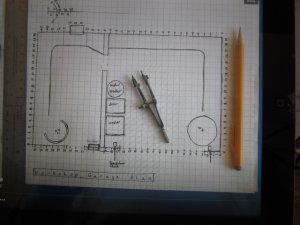

Back from Christmas Break at the Houston Bungalow, have the house most of the way set up
while not in the middle of a forest, like our farmhouse, this one has a spectacular live oak tree. the RR will be in the workshop and the garage, leaving space for a crew lounge and work area in the workshop. and a small car, and tools in the garage
planning on a dual level with a helix to the right, (30 inch radius drawn, but a 24-26 inch radius is more likely. return loop on the extreme left, a city with a small interchange , a sawmill and an iron works on the lower level , long main with a return loop on the upper level with an interchange with a narrow gauge line loop to loop above the standard gauge
