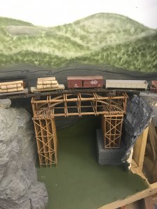

Through shaving one rock face with a knife, and belt sanding the other; I got the bridge to fit properly, One of the rock faces cracked in multiple places, but these are so old they date back to when Tom and I could get fabudrape. The plaster bonded to the fabric , and that left me with a cracked rock face, rather than a pile of rubble.
I was able to flex the cracks, squirt hot glue in the cracks, and then flex them back in place. I Gabe the rocks in place, with some white glue to hold them in position till I do more scenery around them.
Before the bridge gets put in position, I’ll want to paint the backdrop, as parts of the bridge are 1/2 inch from the backdrop , so it will be impossible once the bridge is in place .

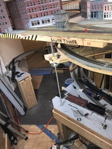

After farting away most of the day with a combination of important planning and then wasting an impressive amount of time, I built 12 linear feet of benchwork, in four 3 foot sections. The two for the lowest level on the back aisle, are two foot deep and three feet long. The two of them will but up against the end benchwork, all ready constructed, and will reach to a few inches of where the cave cove bridge’s benchwork is.
The other 6 feet of benchwork, also in 3 foot sections will fill in between the completed end section of the lowest level of the central peninsula’s end benchwork, and the benchwork where I all ready have a switch for the return loop in place, and wired with a reverser for the return loop, and two switches, so the return loop will have two tracks, to serve as a passing siding, and or Staging.

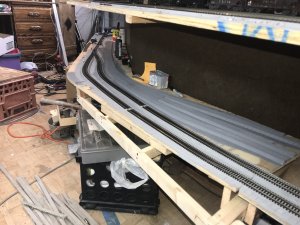

Ok a photo loaded! The roadbed @ Montgomery Furnace.
The mainline in the logging area.
Some pictures off the phone will load.
Naturally, the most informative photos, are the ones it says are too large to load.
My standard gauge mainline is completed, with all the switches in for Montgomery Furnace, and. The log camp.

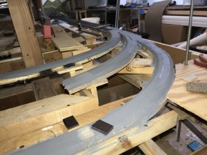

The return loop and it’s passing siding are in , but the photo won’t load.
The old Cave Cove Bridge is in place, this photo is one I had posted earlier, but the link seems broken.

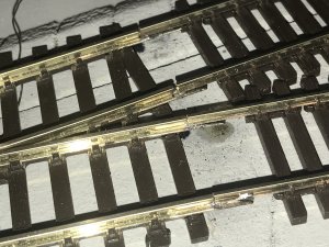

Making a joint between a code 100 switch and code 83 flex track.

The completed code 100 code 83 joint.
I have code 100 in the return loop at the bottom of the helix nook, and at the switches on the left (north) side of the log camp, as I’m out of code 83 switches.
