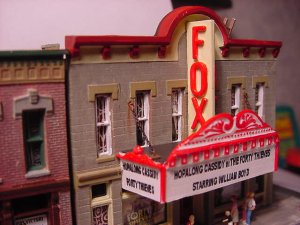

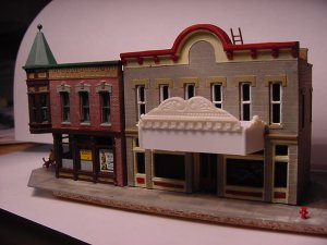

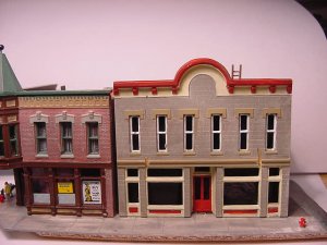

Trying to finish up the last little section of my module town. I posted previously that I cut up a piece of luan in city blocks so that I could work at my bench on the building details. Sure saves on the back not bending over a layout. Needed a movie theater in the town of Grizzly Summit so I modified a DPM building. Started by cutting the slots for the marquee.

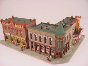

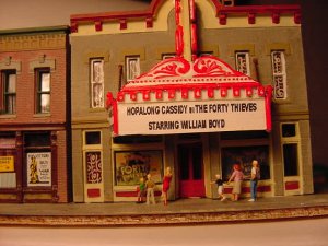

Got so busy with other things that I did not take any more in progress pics. Here is the end result. The FOX letters I cast and attached to styrene. The movie is the Forty Thieves with Hoppy. Those I reduced and printed.

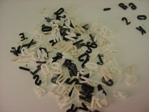

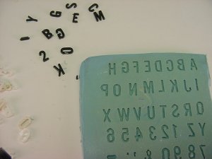

(belg) Pat I lucked out on the letters and numbers. Found an old toy vacuum form toy. The machine was gone but the letters and a few misc. parts were in the box. I made a rubber mold of the letters and numbers. I have several posts on making the rubber molds and casting the parts.

The original letters and numbers are the black ones, the white are castings. The letters are about 3/8 inches (.035") in height. No lower case, just caps and numbers. When I am making other castings, I keep this mold handy to use up any left over casting material, this rather than dump it.
