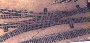

Oh well, there will be a few commercial things even on the surface. Frankly, I'd chicken out handlaying a double slip switch, and once I had problems no end trying to hand lay a H0n3 almost-90°-crossing of two curved tracks! :eek: (On my new layout I'll have the same situation again, but this time I'll simply plunk down a Shinohara crossing, adding handlaid track on all four sides :D )
As you say, mhdishere, when you want to have a track layout after your visions (and not on the given dimensions of comercial turnouts), nothing beats handlaying track. Look at the added picture: On a former layout I had a very tight situation on a yard throat, so I simply had to hand lay the turnouts (this is H0n3, before ballasting). You simply can't have such a tight track flow with commercial trackwork.

I had no problem with spikes in cork roadbed - (8mm = 1/3" thick). On the picture the ties are glued directly to Pavatex, a Swiss version of Homasote - no problems either. So I think you are on the safe side with both of these roadbeds. Take what suits you best. (However I can't comment on foam subroadbeds - never tried it.)
I started handlaying with some hesitation. But after the first few curves and the first turnout which really worked (ok, I had two flops first :rolleyes: :D), I started to love that job. Handlaying can become addictive, so beware! :D:D :D
