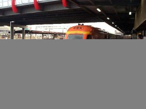

Goodness, this is an old posting. I have since been to Melbourne, even on the corner of Collins and Swanson and I rode the XPT from Melbourne Spenser Street Station to Sydney.
Bob

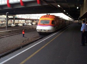

Wonder why only half the pix went the first time? Here is the full pix (I hope) of the XTP pulling into the Spenser Street Station in Melbourne after it's overnight run from Sydney. We departed on it a few minutes later for the 11 hour daylight run back to Sydney.
Bob
