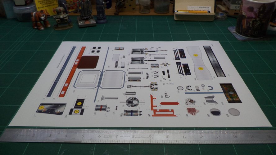

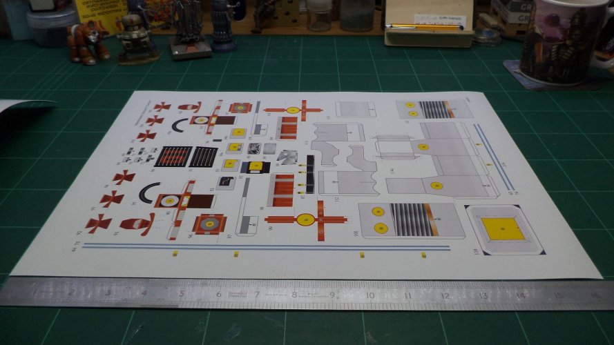

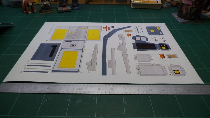

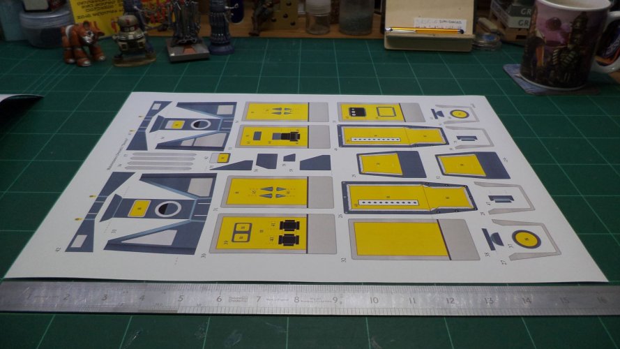

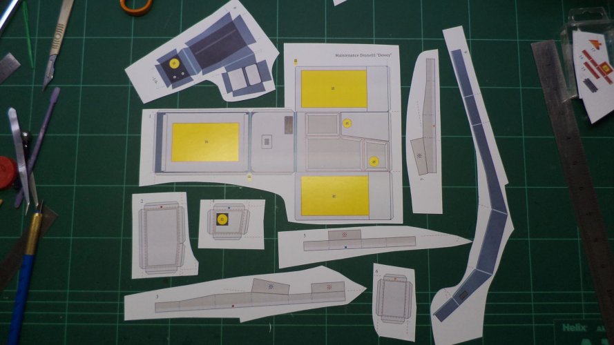

Well on to the build, the parts from uhu, that's all I know from whomever made this model - comes in the form of 4 sheets of parts
Instructions found online were only in Japanese, so bing translate did its best to do just that, unfortunately the translation is at best a rough guide, so hopefully construction will have to follow the pictures which are not that much better at clarifying what to do.
My brother has a wealth of reference material, which he will be offering me in a few days time.
My tools, as laid out are many and varied, but usually I work with just two scalpels from renowned British manufacturer Swann-Morton with a 10a blade (fresh blade with the start of every new build) a variety of other scalpels, knives, scissors, metal rulers and to make my creases, an old darning needle.
Glues used are a fast acting card glue from Deluxe materials called Roket Card Glue and coincidental as per the name of the kit designer - UHU All purpose Gel.
The card glue is very fast acting which I tend to use most of the time on all parts, but larger surface areas are covered by the UHU, not as fast acting, so a pair of self-close tweezers are used or held by the Mk1 fingers with a youtube video ready to watch, whilst the gel takes hold.

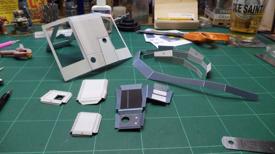

Part one of the build consists of parts 1 to 9 - of which these were sourced and duly cut out... a crowd of onlookers gathered too, so I had to watch what I was doing...
Cutting and creasing began - toing & froing from the pictures to see what was what. Determining the blocks and circled yellow section were for removal, and a odd Asian character I determined was 'crease here'

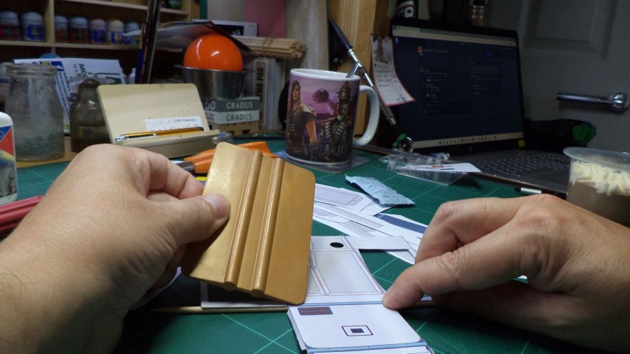

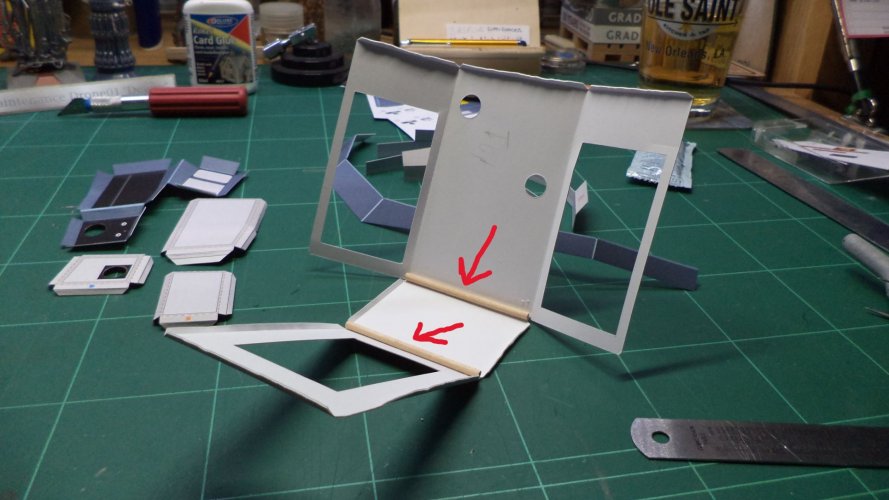

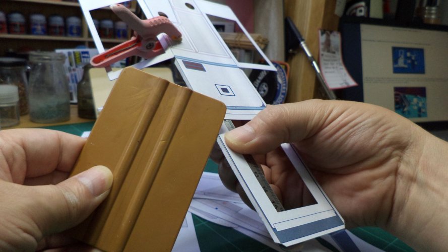

Part one was first creased in the areas required and then formed using a steel ruler clamped to the part and the fold formed using an old 3m tool a friend gave me, good for large areas saving my fingernails grief.
Certain areas on part 1 required a curved edge, so I used a wooden kitchen skewer to help the initial curve, then cutting two pieces the correct width, glued these in place to help the curve stay - curved.
The rest of the following parts were formed and creased as instructed.

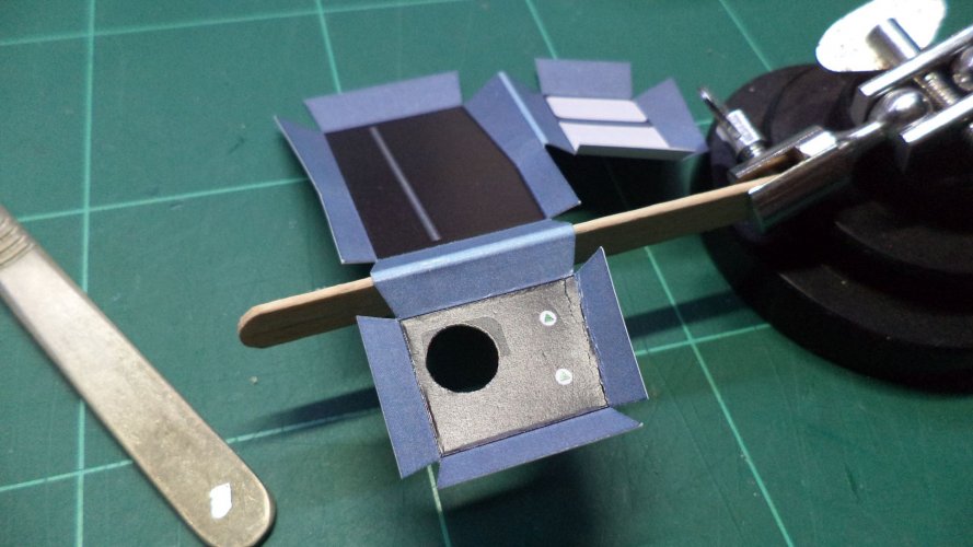

Part 8 was needed to be bent and creased in multiple ways with a small curve to two areas.
A look through all my bits which my long suffering partner shoves in her hand bag after meals, because I usually say "keep this, it will be handy for my modelling" came up with a lolly (popsicle I believe to some) stick with just the right curve to tackle the job.
Ably assisted by my helping-hands clamp the crease was made with no trouble at all.

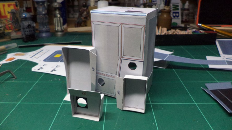

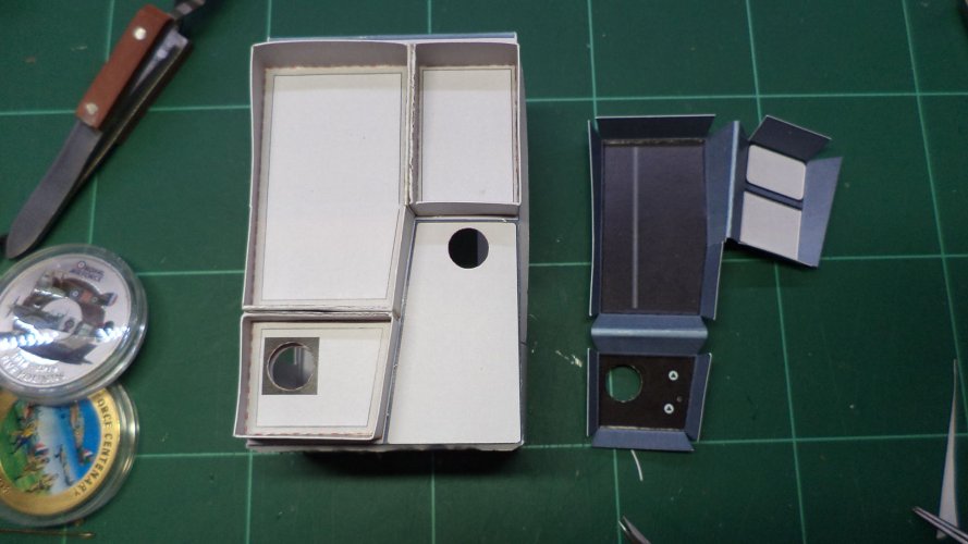

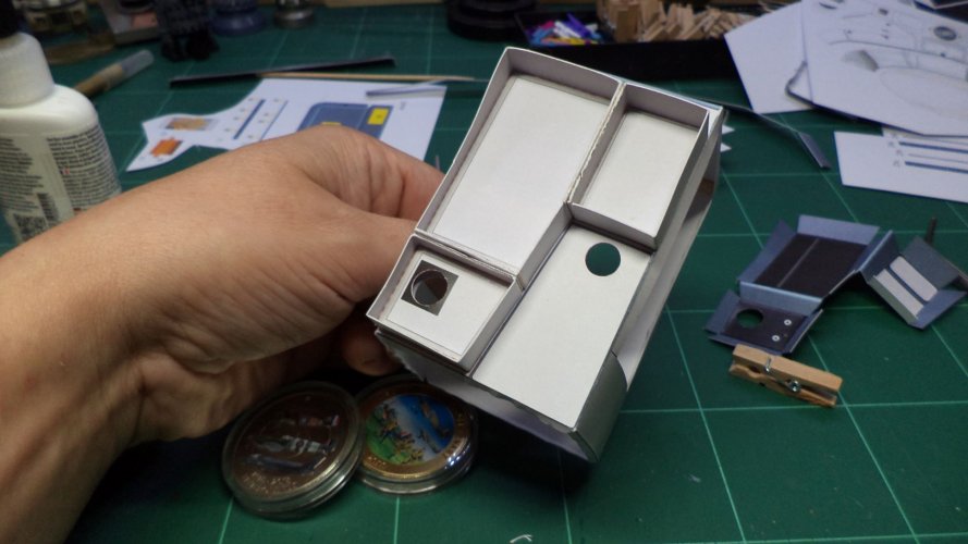

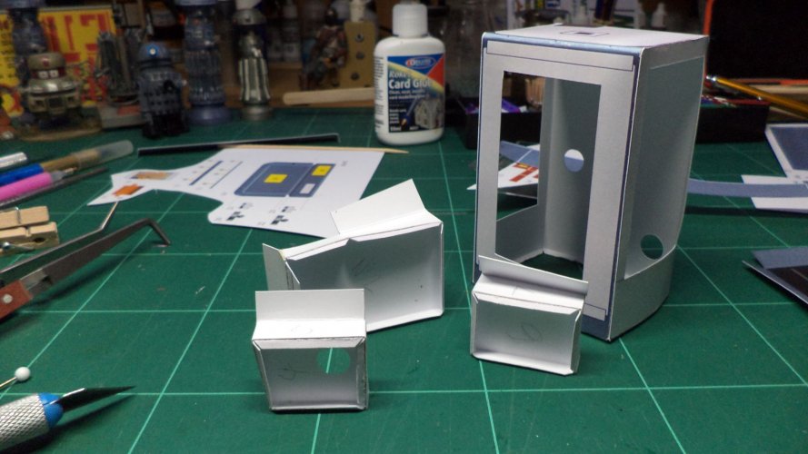

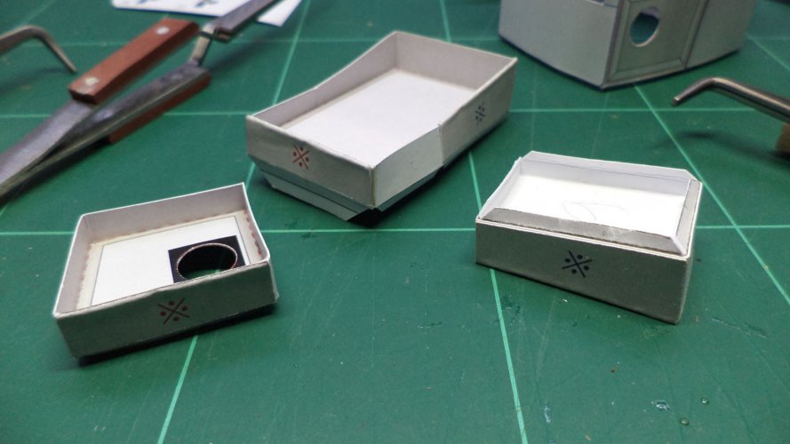

Right, with my parts formed from the first cutouts work progressed to gluing up - nothing too drastic to report at this stage
With three little boxes completed and added to the main body, the drone is coming alive!
It's at this point I have found the paper card I'm using is too thick. From what I recall this print up was on a cardstock for testing, not really for building up complete and showing to fellow builders...
So rather than end it here and bin it, I thought no, lets carry on and if there's any problems then I'll show it warts and all!
Upon hearing there could be difficulties ahead, another 'viewer' joined the ranks...

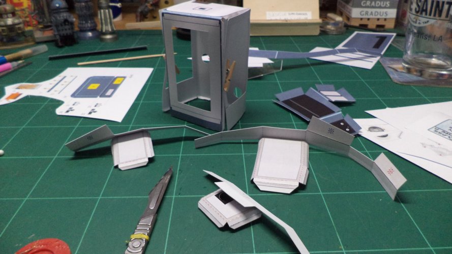

The insert for what I'm calling the faceplate was next - the engineering of this card model is outstanding and the part nearly fell into place.
Partly I think, due to the card, there were a few gaps, but they are hardly noticeable.
That done the drone has a face, features to come later...

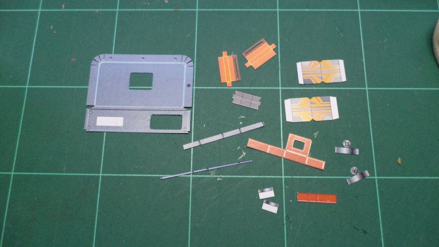

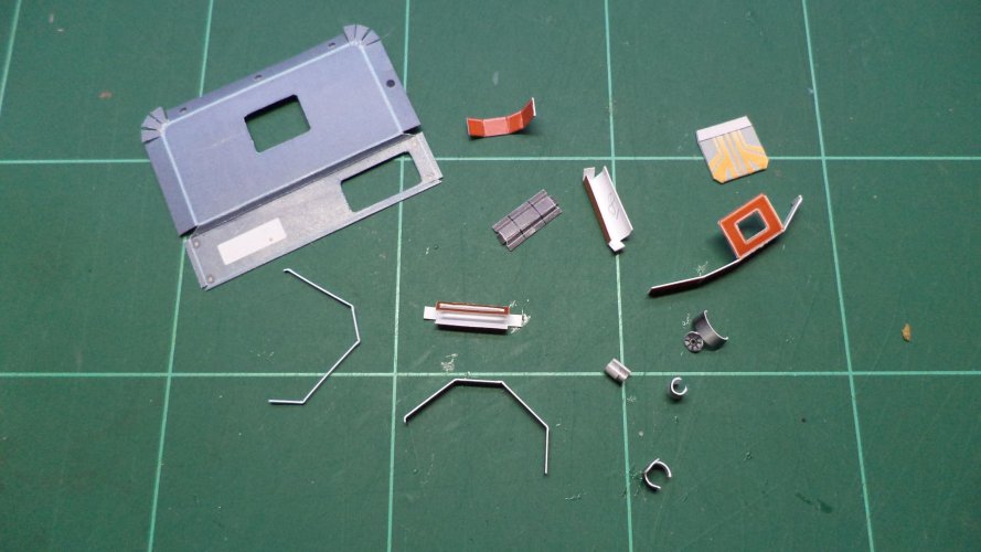

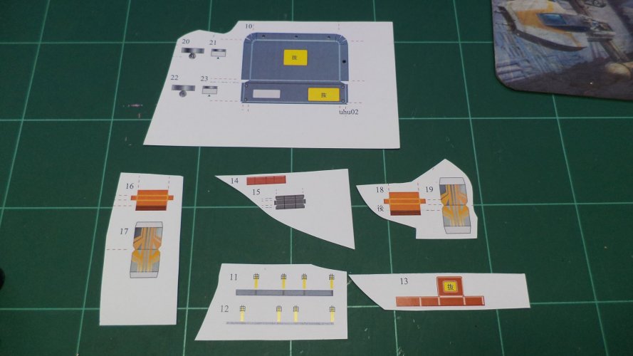

Time for the top part of the Dewey's nugget and numbers 10 to 23 were duly selected, cut and creased and a few swear words shouted at the tiny pieces 20,21,22 & 23 as they required being rolled into tiny tubes...MY OBSOLUTE HATE of paper modeling, tubes and rounded things..."I HATE 'EM!"

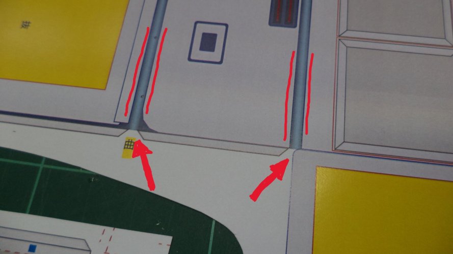

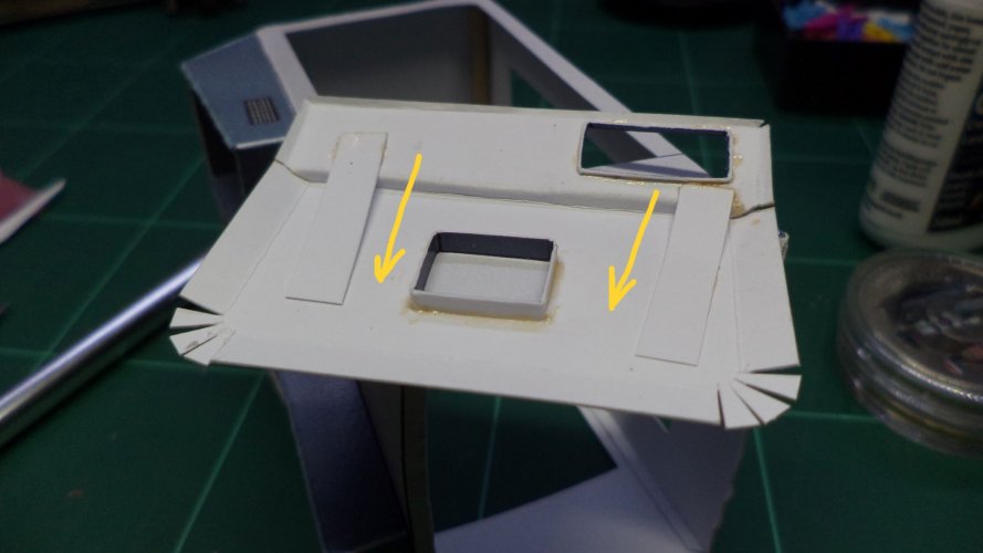

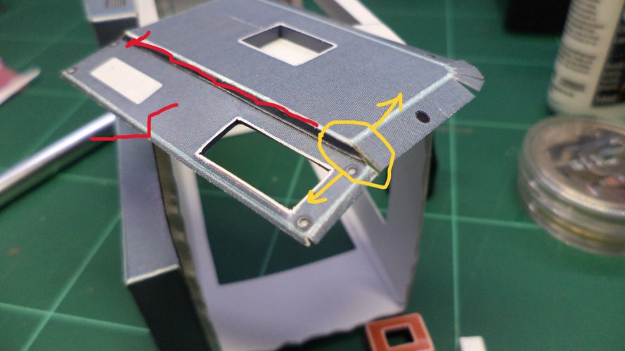

A flat panel sits on top with a small step, unfortunately the tiny step with the thick card was proving hard to keep upright - the red line sowing the step and the yellow circle with arrows showing the two areas which wanted to stay flat.
My solution (hopefully) was adding two strips, one part at the bottom of the arrow was attached first and allowed to dry, then pulling in the direction of the arrow and reforming the tiny step I glued the other end down.
We shall see if this hold out...
