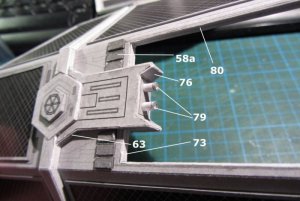

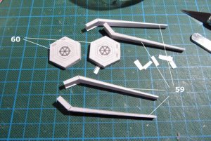

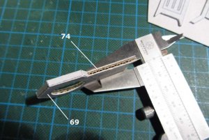

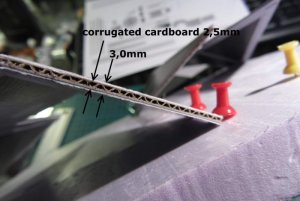

Hi,

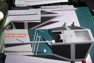

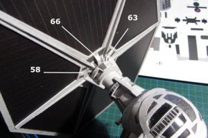

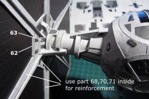

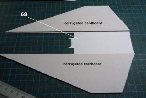

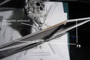

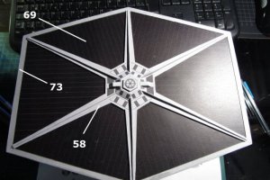

these pictures show how I built the wings of the Tie-Fighter. I used for part 58 reinforcement(parts 68,70 and 71) made of 1mm cardstock and I glued it inside.
@ dnalor : I use corrugated cardstock, additional reinforced frames(58 ) and it is also glued in several layers like a sandwich. If you knock on the wing, it sounds very strong, like wood :mrgreen:

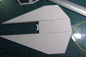

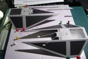

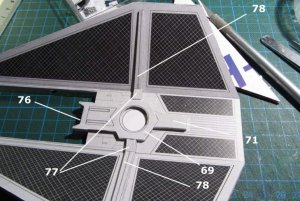

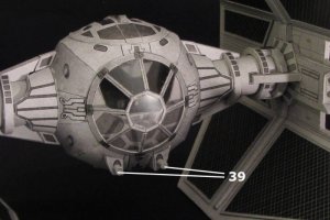

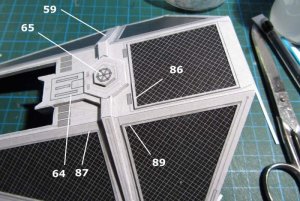

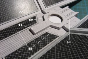

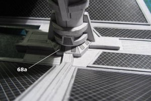

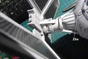

Hi,

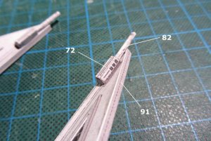

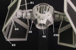

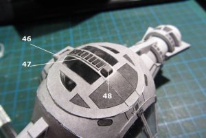

that was the Tie Fighter. Now you can see show how I built the wings of the Tie Interceptor:

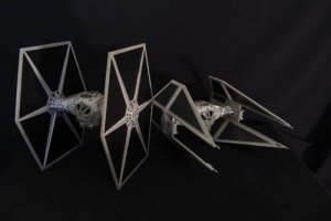

Man am I biting my tongue here! Beautiful workmanship Loenf, beautiful. Until this Tie Fighter, I have never see an Tie Fighter so elegant! Truly fantastic! :)

Great Tut. how to build it..
never thought about it to use the corrugated cardstock and glue normal cardboard over them..nice :)
Nomex Honeycomb, which is quite flexible till epoxy is applied is similar to cardboard and it's application in this case. In a helicopter blade, the Nomex Honeycomb material is doped with a proprietary epoxy resign and carbon fiber is applied over it. The rigidity of the Nomex Honeycomb applied with the tensile strength of the pre peg carbon fiber cloth makes for a very strong, stronger than ay metal, blade, yet flexible, once out of the autoclave, of course. I have seen Blackhawk Helicopter blades with multiple rounds threw the blades and the craft have landed safely. The picture below is of an S-76 blade.
That being said, a corrugated piece of soft cardboard doped up with a stiff glue or resin, can make, cut to shape first, could be a great basis for a strong part. The same cardboard unglued would be a moisture sponge. Glue of some sort is needed to seal it, resin, liquid crazy glue, would make it very stiff, though the health concern for a model part is kind of high. The part showing the cardboard interior looks very industrial! :)

Once again Future comes to mind....what about a coat or two on the corugated before it's assembled....Maybe dry it between coats with a hair dryer. This stuff is so versatile, might be worth a try! And it's not toxic, like superglue or resin...

Amazing clean and crisp build. Your models look like computer generated renders of 3D models.

The upclose shots really show off just how well done this is. It looks as good upclose as it does far away. Truly impressive.
Truly, I have not see any Star Wars craft that look this tight and crisp. They do look like computer renders. You would make George Lucas Proud! :)
