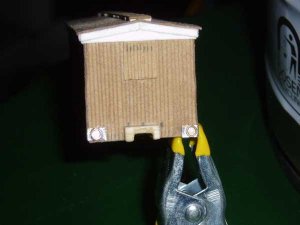

I have made them before by making a tiny loop of copper magnet wire and soldering it to a small strip of brass. Not perfect, but not bad either.
Kevin

And since your car is HOn3...you're showing it at 2x the actual size! Very impressive!

You can make these from styrene, too: use either a straight slice of styrene tubing, or make an angled version. If the car has wooden end beams, cement the bit of tubing to a square of .005" or .010" sheet styrene.
The car below shows the angled version.
Wayne
