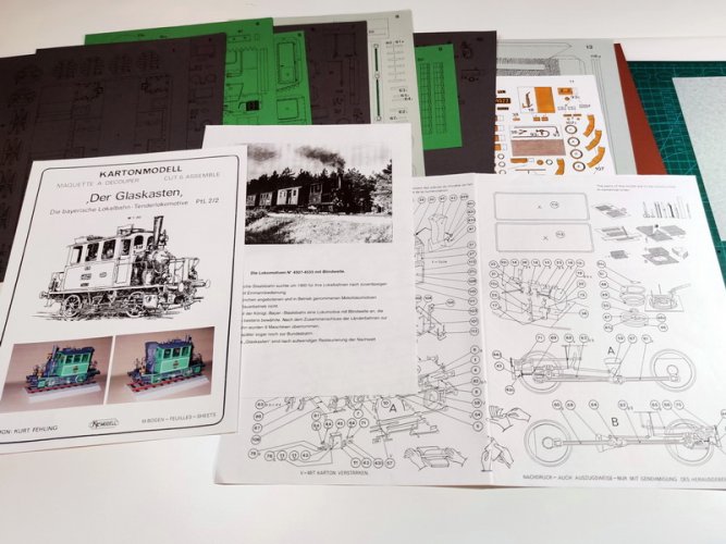

This is a very nice model by Kurt Fehling (KF Modell) that has the particularity of being printed in different colored cardboard sheets. This should avoid the need to paint the edges because they are in the right color. Anyway the final result is not at the quality level of a color printed model (the sheets are printed in black). Especially the black parts (printed in black on dark grey cardboard) doesn't show well their details and the overall result is a little bit "confuse".

And this is the cardmodel I started from. You can see the colored cardboard sheets printed in black. Only one is white and printed in color.

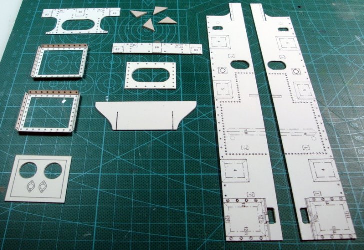

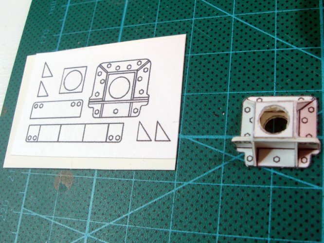

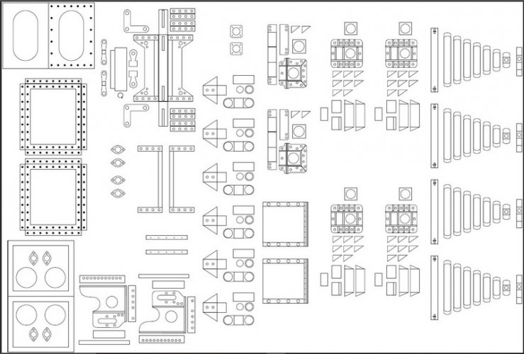

I scanned all the the sheets, printed them on white cardboard and started drawing several additional details to be added to the chassis to enhance the shapes. My work is based on the documentation I received from my new german friend.

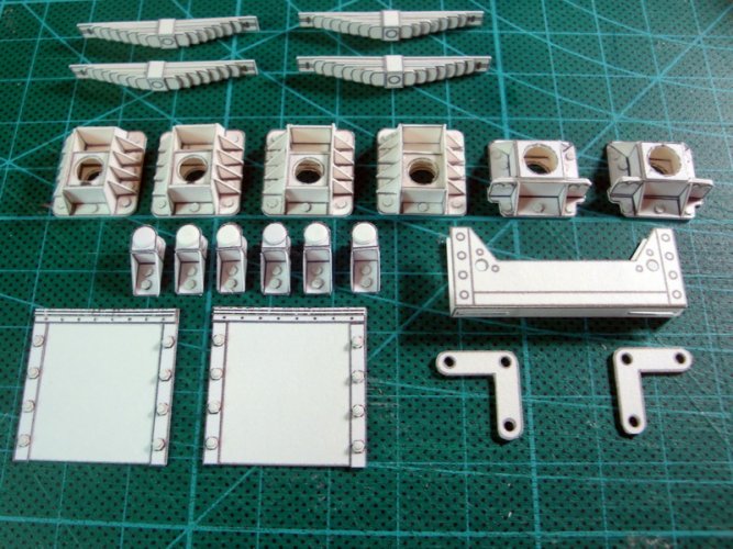

This is, just to give an idea, the first batch of new pieces I realized to complete the chassis.

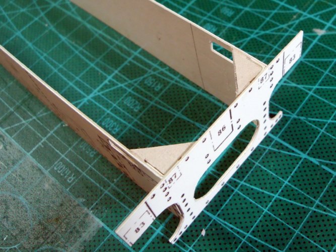

And the build starts...
Some of the chassis parts ready to be assembled
All the parts you see here are taken straight from KF model.

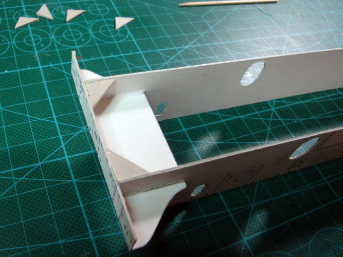

To strenghten the structure and keep it square I added little triangles at the corners

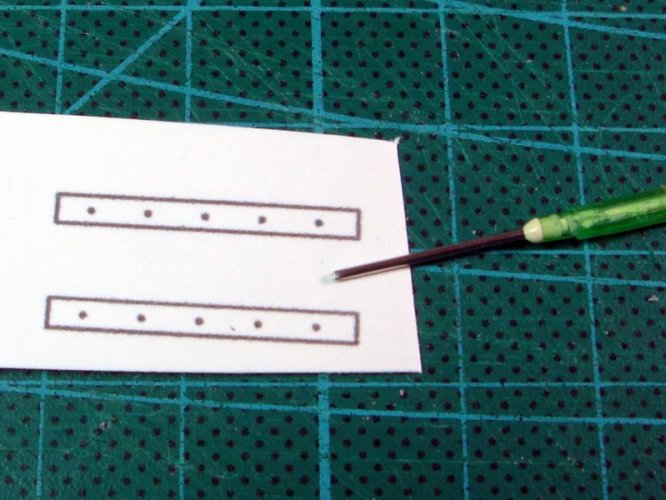

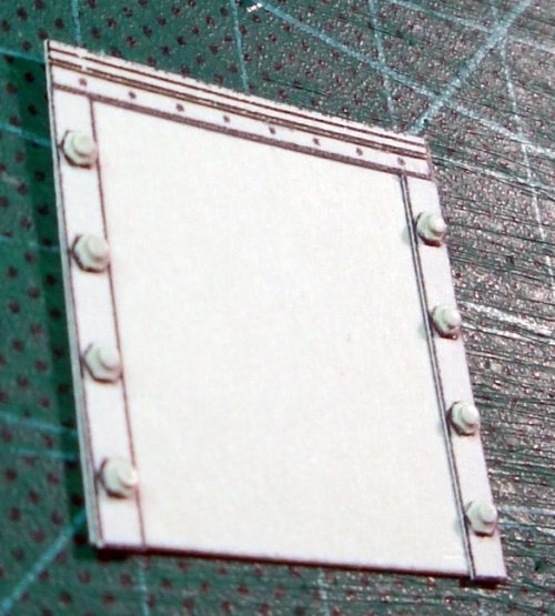

To simulate little rivets I used a syringe needle pressed onto the surface

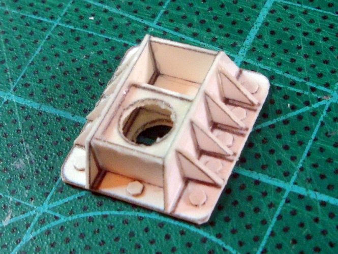

This is one of the revisited axle supports.

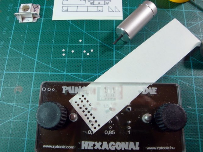

I decided to realize all the bolts from cardboard using my invaluable punch'n die tool from RP Toolz. This way I can fix the bolts using PVA glue.
The final result is pretty nice. Once painted it will be very realistic.

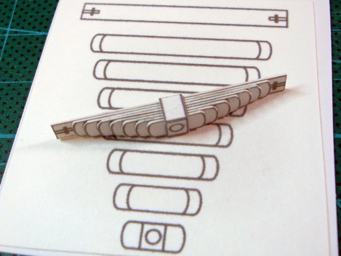

And this is the first suspension ready to be attached to chassis side.

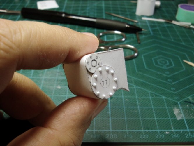

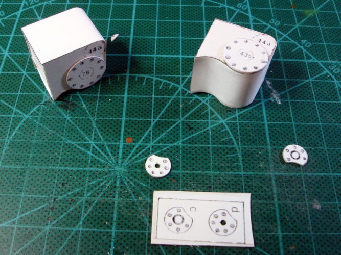

I'm starting to enjoy making bolts. Here I put little circles in the center of the bigger ones (this is the cylinder mounting plate) to simulate the screws.
This is one of the suspension attachements

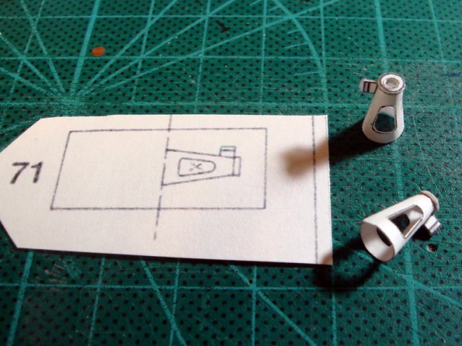

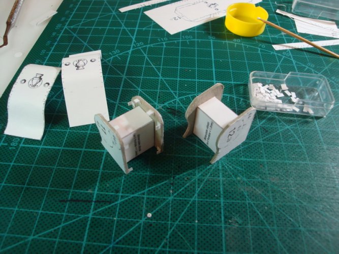

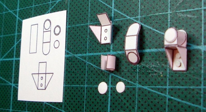

A nice trick to glue little paper cylinders without going mad trying to keep them round while setting.
And this is a first batch of chassis parts ready to be attached to main body.

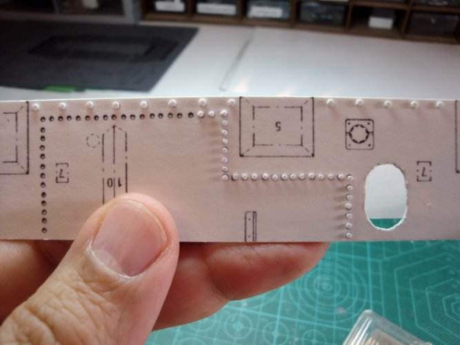

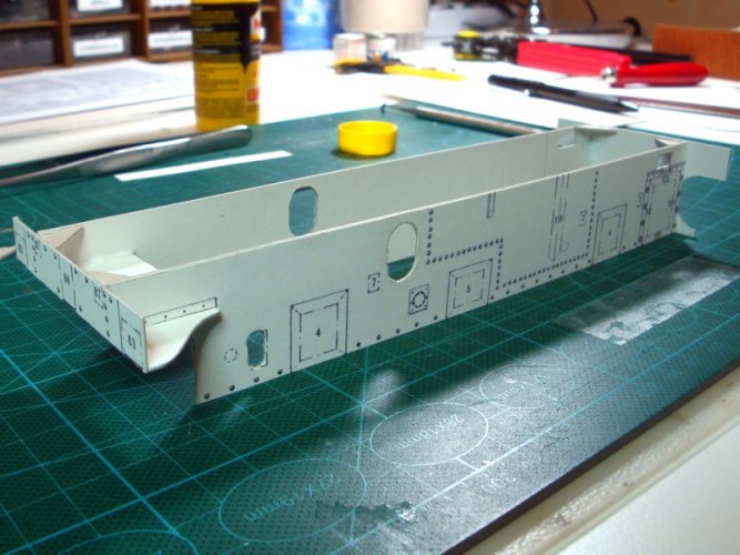

But before doing this I have to solve a rivet dilemma...
I wanted to avoid too much punch'n die work, tried putting little drops of PVA glue to simulate the rivets.
I added some color to the glue to better visualize the drops.
Unfortunately I soonb realized that is very difficult to obtain drops of the same size and shape.
This try was a complete disaster. I have to clean the side wall and restart from the beginning. I must find another solution...
