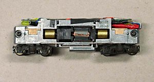

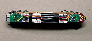

In case you change your mind and give the milling of your frame a try (the only tool you need is a file), I post these pics of the GP7 with the DZ123. If it goes wrong, you can still buy the Southern Digital frame.

Now that I look at it, it looks like I only need to file off a small part of the frame. I'll have to dig around and see if I can find a file somewhere. I'm new to DCC. Thanks for being so helpful.
