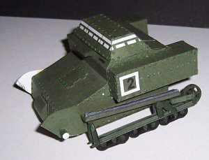

I'm not sure that simply sticking card disks onto a model to represent rivets is the best that can be done. I looked at this a while ago and found a reasonable technique was:
- cut out the disks with a punch
- edge colour the disks
- shape the disks to a dome shape with an embossing tool. If there is a tendency to delaminate dip the emboss tool in diluted white glue then form the shape. The white glue seems to help the embossing and sticks the paper layers together.
- glue on model taking care not to flatten the shape.
Attached is an unfinished T-27 model with rivets made with this technique. The model looks crappy mostly because I had use flash to get an image.

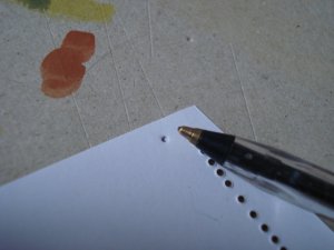

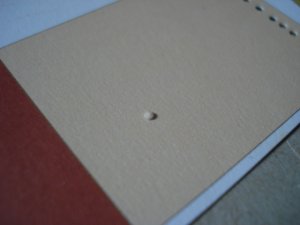

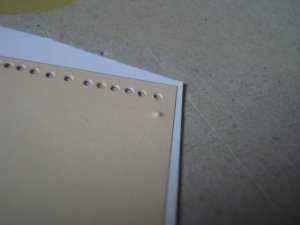

thanks ill give that a try the rivets on that t-27 dont look any different from the ones ive been making i did however find a method of making rivets rounder..by using an old biro to make a dent in the card on the reverse side and punching it out

Surely you're not going to drop something like that without enlightening us? :)
nothing to it i simply keep punching disks until the bit on the screw punch is full of them, i then take the bit out of the punch put it on a flat surface and carefully poke a cocktail stick down the cutting end... 8 times out of ten they stay together in a a little cylinder which i then paint before breaking them up into individul disks i can do up to 40 like this at a time with this method running a damp paintbrush over the matirial to be punched helps to keep them together:mrgreen:

the biro method i posted earlier makes a simalar shape
Thanks for that great biro tip, as well as the one about painting the little stacks of discs as a single cylinder. Clever ideas! I am always looking for "mass production" techniques like that. When my screwpunch arrives, I'll try that one!
