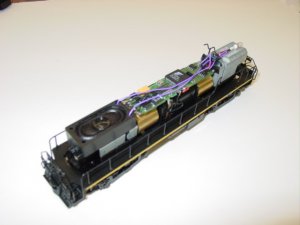

Here's the 35mmx16mm oval speaker installed in the Atlas RS-3.
The front weight is cut down. I also had to remove the front bulb, to make room for the speaker.

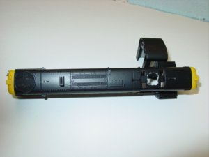

Here a shot of the shell. A hole was cut in the cab area, to make room for the speaker capacitor. .016" holes are drilled in the fan grill area to allow the sound to escape.
Gary you are right. The speaker installation is the most difficult part in installing sound.
The sound is excellent. I'm very happy with the results.
