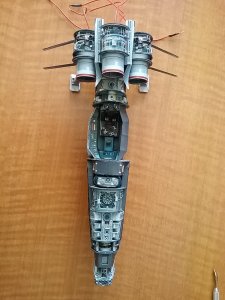

Dan, this is one greeble no one has done that I believe will really take this model over the top. All needed is a little Exacto blade work, and some fabrication, simple fabrication. The pics below are self explanatory. See what I am trying to tell you? :)

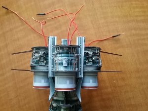

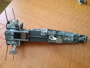

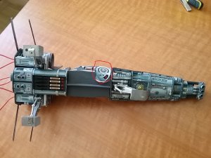

Ok...some update.... and thanks for your good comments
I dont know what's the name of these pieces but i call it "the donuts". I tried the initial buld but i didn't like the accuracy of it. So, i find some styrofoam sphere with the right diameter. The finish of these "balls" have some imperfections. To correct that, i put some plaster, sand it and paint the pieces.
Before gluing those parts, i welded the blinking LED lights on the wires.

Like I said, it was quick and dirty. It took me 5 minutes. The point was to cut the whole out of the housing, and recess the center portion, which could done easily, and in place, with a sharp Ex-acto blade, and a tube containing the rounded portion. That piece just doesn't look right. Not by the way you made it, but the design. If you recessed it to the bottom line, then made the insert "tube-like" assembly into it, and the round inside assembly pushed in even to be flat with that bottom line, I believe it would really add much depth to that area which is lacking depth, again, by design, not your build. :)

Looks great. You going to make light diffuse panels? The pic below has a nice balance. They couldn't be too bright or they would blind the other pilots. I like that they put the light deep in, not blocking the variable exhaust vanes. :)

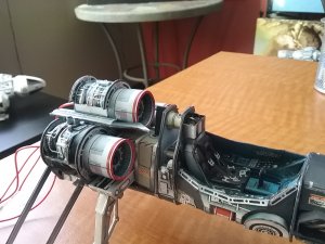

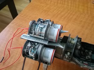

I guy's,
UHU02 model is incredible so, for me, it's important to build something special. I'm builing right now one of the exhaust......It's gona be cool. I will post a small video when complet with the light on. For now, it's a surprise :). Have a good day friends.
