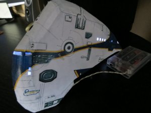

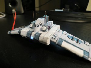

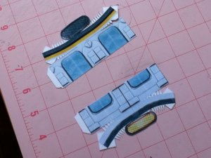

I'm back again and started a new build. The BSG Colonial one. Like my other build, i love to do more than cut, mark and glue the parts. I love to add some détails and lights and this model will be challenging. I try to reproduce my construction like the pictures we found on the net.
I started with the head. The first build was terrrible due to the cut I have to do for the windows and preparation I have to do to prevent the light from passing in the through the paper. I scraped it. The second attempt was not bad but I was not satisfied. The third was better but I'm not sure.
I decided to steep this piece aside and do the fins and the back engines.
Soon, I will start the ring (this one will be cool with the lights) and the hull.

Assembling the curved parts of the head in this high quality is simply breath-taking! Even at this early stage your build looks much better than mine!!! (My head is slightly warped...)
Some words of caution: Inserting the head into the main body is a bit tricky. You may need to widen the front piece of the neck a bit to make the gap large enough to accept the head.
Are you using greaseproof paper for the windows?
What about the engines? Will they be glowing as well?

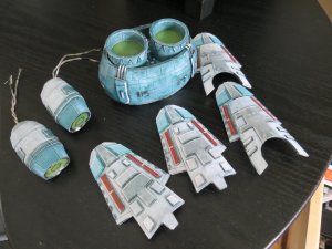

All the engines will be glowing and the ring engines will be also glowing. For those one I will post some ''How I make'' pictures to show the bulding step. So stay around I will post someting soon.

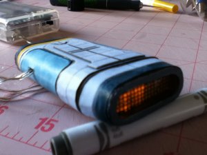

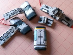

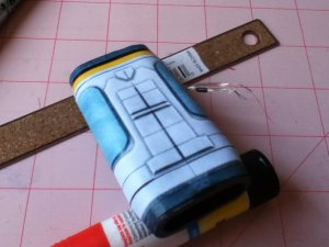

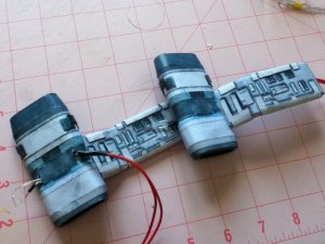

I almost competed the engine. The next stage is the improvement and the détails.
Some tips : I put some black electric tape Inside the piece where the light glow. It avoids seeing the light somewhere else that the place we want to see her.

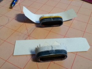

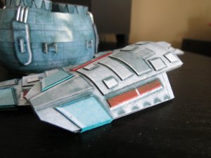

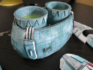

Some computer problem......I'm back !
I completed 2/3 of the ring engine.
For enhancement I printed the pieces several times on high quality paper. Before sticking thenew parts, I sanded the harshness to have the softest possible forms. I take an other set to make the détails. In summary, I print four or five times the parts.

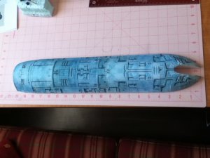

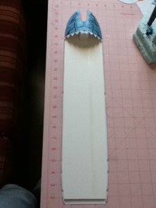

I already assembled the lower hull and this is how I do
First, I cut and assembled the pieces 17-18-19. I cut a piece of form core board and glued with stick glue on the skeleton. I make sure that the tabs goes up to glue the body parts. That help me getting a solid and plane surface. It is easier to stick the hull segments.
After that, I glued the hull segments 20 to 25 starting with the part 20.
I didn't put the inner skeleton cause the piece are to high. So I've made them with form core.
I think you did a great job with the mesh. The are ok. :)
