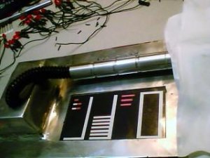

If any one try’s to do it in mettle start with the neck parts first and then the backpack it will go together allot easier. :D

If any one try’s to do it in mettle start with the neck parts first and then the backpack it will go together allot easier.:mrgreen:
Wow, Red, that looks awesome. What are you using the weld the aluminum, Oxy-Acetylene, Heli-Arc or plasma?
You've really put a lot into this.:thumb:

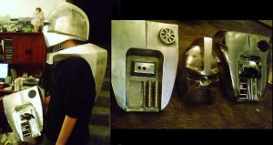

I am Tac welding with the sigma 1st then going back Heli-Arc and then rough grind then sand then a finish sand and then polish.
I need to add some lights to the control panel on the back pack when it is done, and then go to the fabric store and see if i can find the stuff to make the jump suit that was worn under the armour and then find a pair of black cowboy boots to put some aluminum tape on the heals and toes.
thats the plan :D

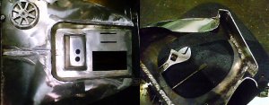

here some more pics
I am Tac welding with the sigma 1st On the Inside then going back and Heli-Arc the outside and then rough grind then sand then
heli - arc the cracks wall1 then sand then sand again and again working up to 2000 grit finish sand and then polish.hamr alot of work :wink:

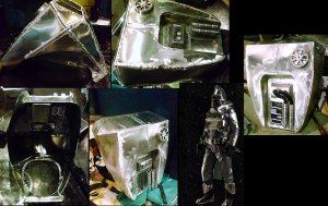

I was able to put 7 more hours in to this :D and now im ready to do some more sanding when i get it home. thumbsup
smoe of the guys at work seemed interested in the hole cylon thing i told them to chek out your web site bazookajo and Zealot.com for other models

Look stunning Red, great job, I'm truly impressed with what you've done to this. you need to make an extended mediums thread!:thumb:

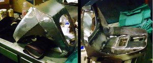

well i got it home today. :D
did a littel sanding took a brake came back and my son had it on sign1
it still needs more sanding befor it can be polish.:rolleyes:
now I need to get started on the chess plate thumbsup
Paper first though it works better so you know what you need to change to make it work in mettle :D
