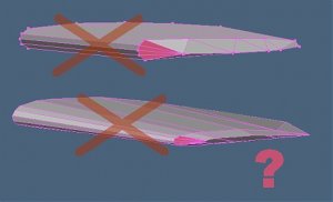

Being my first attempt at an aircraft Dev, I guess a few hiccups were inevitable, although I wasn't expecting one straight out of the barrier.. After lovingly texturing my Devastator model, I've discovered much of it was a waste of time ( I'll have to re-design a chunk of the 3D mesh)
Brain-strain # 1 ~ How do you get an aerofoil / wing to un-fold as a single part ? ( joined at leading edge) I've tried multiple variations ~ open ended wing tips / closed wing tips, unrealistic thickness at the wing tips ++++ ... I just can't figure out how to translate the rounded + tapered leading edge, to flat wing tips ~ so the wing un-folds as a clean 'upper and lower surfaces' etc. Is there a trick to it?, or is it a limitation of the META / PEP combination.. ( + designer).. is there a post addressing this problem/design issue anywhere.?
I'd be grateful for any tips..

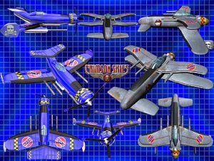

When Crimson Skies came out several years ago I made 3D renders of the aircraft for the Flight Clan I was with.
Recently I started digging up my old files after seeing [and building] your Pandora model.
Here are some of my old [CS] models:
http://forum.zealot.com/attachment.php?attachmentid=66503&stc=1&d=1206901691
I can remake these models so they would be acceptable for card modeling, and I can send you the files.
I would like to be able to have some planes to go with my zeppelin.
So let me know what assistance I can give?

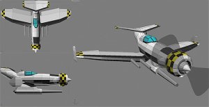

Ok, I went back and started to simplify the models and I have finished the Fury.
http://forum.zealot.com/attachment.php?attachmentid=66539&stc=1&d=1206929389
Then I hit a little snag; I am pretty ace when it comes to 3D modeling programs like 3DS Max, Bryce, Lightwave, etc but it has become painfully obvious that I need to learn how to unfold, I am using Pepakura Designer2 and it totally twists my models around.
I found some tutorials and I will spend the next few days figuring out how to use it properly. Hopefully I will have mastered it at least enough to design, print and build the first paper fury [that I know of].
But if anyone wants to give me a hand I'ld appreciate it.

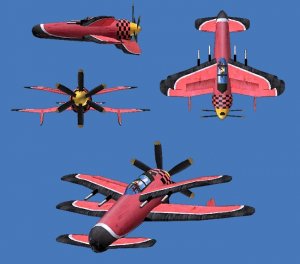

Devastator
As long as this thread has bumped, I might as well move camp. There's a bit about the Crimson Skies Devastator in THIS thread.

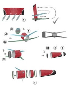

The plot so far... Thanks to the way I've designed it, there are a few vital steps in the build, so I'm just making up an Assembly Guide to ensure a happy build + few tweaks etc
Oh yeah.. If any Aircraft builders are tuned in ~ Is it a usual feature on Aircraft models (commercial?) to have options for rotating spinners/props..??? or is that left entirely up to builders..? ~ Is it worth including a few extra parts (just in case) ?

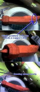

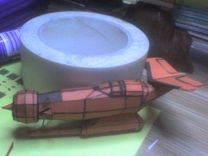

Quick update on the Curtis-Wright J2 Fury
Hi guys just a quick update on the progress of the Curtis-Wright J2 Fury.
Its going great, a little tricky but puts together really well.
http://forum.zealot.com/attachment.php?attachmentid=66634&stc=1&d=1207096794

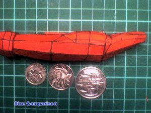

I think that the only main change I would do to it is change the scale I printed it at. The final model when complete currently fits in my hand.
I think most people might find that a bit too small.
http://forum.zealot.com/attachment.php?attachmentid=66639&stc=1&d=1207100133
So I'll release two versions, one at 1:72 the other at 1:32
Also given the large variety of pirates, security firms and militias available what do people think of having a decal sheet instead of textures?

Well I am almost done, realised that the ends of the rear wing were too small and too complicated so I chopped them off.
Anyhow I have a progress pic for you.
http://forum.zealot.com/attachment.php?attachmentid=66661&stc=1&d=1207118100
If the black lines look shocking, thats because they are.
I slapped them on using a black marker to help enhance the fold lines, cause the first couple of pics didn't show up too well.
Just the wings to go now.
