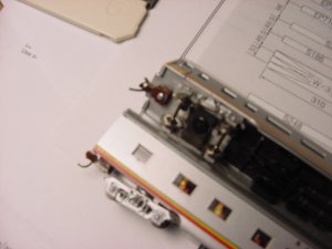

Converted my entire string of smoothside passenger cars, seventeen total to Micro Train 1015s. Rather than buy new trucks I just clipped the rapido couplers off the existing four wheel truck and mounted the M/T couplers to the car underside. (Some did require shimming.) Ran the entire 17 cars at the clubs last train show most of the day with only one car giving me grief. Belive I have to replace the truck on it. I like to buy the bulk pack of unassembled couplers to save money.
