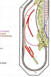

Well...as construction on my layout progresses I occasionally have a brainstorm and run back into the computer to make some modifications to what was SUPPOSED to be my final track plan.
I'm at it again. :rolleyes:
First of all, here is what was supposed to be my final track plan before:
Well, the thought suddenly occured to me that if I lowered the elevation of the hidden staging to an elevation of 0", I could easily tie the BNSF branch line and the UP interchange line into the staging yard...making it appear that they do indeed go somewhere (which some here recommended). So, the UP interchange and the BNSF branch line now disappear into tunnels and go to the staging yard.
While I was at it, I also ran the outside mainline AROUND the hidden staging, giving me the appearance of having a single main over the "summit". Note that the hidden main holds an elevation of 2" while the staging holds an elevation of 0". The now "single" main continues to climb reaching the "summit" at 3".
I also made some minor changes to the southern industry area.
Here is the new "final" track plan:
Now...finally....just help everyone see what I have in mind, I dashed the lines of what will be hidden track...be it hidden in a tunnel or hidden behind what will be a removable backdrop (blue line). I also sketched in some scenery to help illustrate the future tunnel areas. Here's this:
It should be noted that I intend for the tunnel covering the staging yard lead running around the west end to have a removable top so I can get to any trains that have problems in that long tunnel. The rest of them I should be able to access easy enough without removing any mountains.
Well....have I gone and overdone it or what??

AAAACCCKKK! Hoss!!! Whaddyadoin!?! Just kidding!!!!:D
I think your last minute modifications make sense, and I'll bet if you took a poll you'd find that a lot of us made changes in track plans during construction...and even later! :) Now, get back to constructing!!!:thumb:

I Like It!!! I like it alot.Just be sure you have good access to the hidden trackage.and add a lip of hardboard,call it safety rails to the hidden trackage to keep any derails from doing the 2500 ft canyon plunge.I ran mine about an inch high.i used lightweight hardboard nailed and glued to the side of the plywood subroadbed.Looks great,now get it built!!:thumb:

I think you have a marked improvement, with the working interchange and hidden staging. I would suggest that instead of a removeable scenery piece over your long tunnel, you make the fascia removeable or with openings to watch/access the train through that section.

Hi Hoss,
Me again. Sorry I have to reply here since I do not know how to post pictures at Trainboard...
Anyway, here are the modifications I originally suggested.
At the southern end, didn't there used to be a run around track? I thought then a siding heading north would provide some challenge... But it doesn't really have enough space now that you have eliminated the "Y"...
So to the spur slightly further north, I added a siding in the opposite direction.
Both my suggestions are in red. It would be cool if you could work in a diamond of some sort.
As always, these comments are only worth $0.02...

Russ, my point exactly. I would much rather make changes now in the planning and early construction stages than to make them later when it will cost me more time and money. ;)
Tyson, one problem that I have always had in designing a track plan was having "too much". I tried to avoid that on this one and give myself more room for scenery. I was afraid I had failed at this until I placed a decent sized N scale structure on the layout and saw how small it looked. While I prefer the appearance of the single main, I want to have double main operations. While I want to limit the industry spurs, I still want the railroad to have purpose. While I want to avoid unnecessary track, I still want to have the appearance of my tracks being tied into the rest of the world (hence the UP interchange and BNSF branch line). I guess it all comes down to compromise. I'm hoping that I can hide enough of the track with scenery to have it still look good...while at the same time have enough track to keep things interesting. Thanks for your comments.
Tileguy, thanks. Good advice on adding a lip to prevent the 2500 ft. plunge. I actually had not thought of that. Something I will need to consider and plan for.
Yakko, great idea on having a removable fascia on that end. I think that is a much better idea than going with a removable mountain top...and I will have the room on that end to do it too. I'm glad you mentioned that. Thanks!!
MasonJar, I'll take your suggestions into consideration. I like them, I'm just not sure how well they'll fit. I have found that what I can draw in Paint and what RTS will allow me to do are not always the same...not to mention what can be done in actuality. I'll see what I can do on that.
