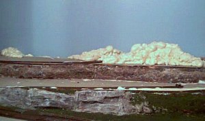

Here's part of the completed cliff on the second level. I also have cast cliffs on the canyon to the right (outside of view) and the cliff on the lower level on the left (also outside of view). There isn't much to see yet on those outside bits because I haven't painted them. I think I'm going to paint the rest of the foam, then cover it with grass, weeds, bushes, trees, etc. to hide the "unusual" contours.
I used brown as the base color for the second level. I'm trying to simulate a different kind of rock--more reddish and brownish than typical gray limestone. The upper level will be a lighter and redder brown, if I can figure it out. (But most of it will be covered by grass and weeds). Despite all of my work on the second level cliff, most of it will be covered by the buildings of the town! :p

Drew1125
Jan 28, 2001
2,975
No snow om Copper Ridge?:eek:
It's looking really, really nice Rory!
I can't wait to see all the undergrowth sringing up...
(from under the melting snow :D )
