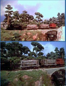

New Bridge
Here are a couple of pics of the new bridge. It's carved out of a piece of blue insulating foam. It's located near the right-hand edge of the layout, which is why its kinda crammed into the right sides of the photos.
Sorry for the blurry photos... My camera doesn't do a very good job at close ranges. I'm going to try to borrow a better camera this weekend so I'll have a photo for the contest.
The two 70-ton hopper cars and bobber caboose were weathered by Tyson. Thanks again, Tyson! :)
I've decided to move the town from the second level to the top. I might put an abandoned mine on the spur on the second level, with a couple of derelict buildings where a town used to be. I can still use the spur from time to time...

Excellent piece of scratch-building there, Rory!
How about an entry in the photo contest?

Rory, More excellent photo's and modelling my friend, can't believe it's N-scale.

I'm currently working on a revised version of the bridge that I submitted for the photo contest. The original bridge looked too thin to me, so I made the new one thicker. It's going to be a trick to mount it in place, though. First, I need to remove the track from the front side of the second level and re-lay it. The expanding foam upset the level of the track, so it leans a little too far in a couple of spots. After I remove the track, I'm going to use the hacksaw to cut it down more level. Wish me luck! :rolleyes::)

So, construction is continuing... I was having a problem with most of the second-level track along the front of the layout. When I put in the expanding foam, it tilted the track severely to one side, and engines were having a difficult time getting good electrical contact. I pulled up the track with the intention of trimming the underlying foam, but quickly realized that I wasn't going to be able to get any kind of blade into the area. So, I took a tip from the real railroads and used ballast to level the track.
But how would I know if the track was level? I was having a great deal of trouble trying to get an accurate reading with my level. But then I had an idea: I took a couple of the little bubble thingies out of my level and taped them to the flat car that I had made to carry The Box. By placing a track pin between the rails behind the car, I could park it over a section of track while I arranged the ballast underneath with a pick. Below is a picture of my levelling car.
Also, I put the new bridge into place. I wasn't satisfied with the old one because it looked too thin to hold hundreds of tons of ore cars. So, I made a thicker one. Construction was the same, except that I used two pieces of the blue insulating foam. The new one is made to look like its composed of random stone. After the ballast dries, I'll spackle the ends into the cliff faces and paint the abutments. Then I'll post some more pictures...
