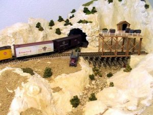

Her is a photo of a 3' X 6' n gauge layout I built back in the 80's . It was built using the cookie cutter method.

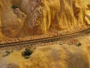

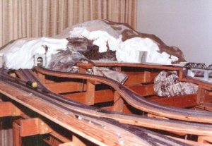

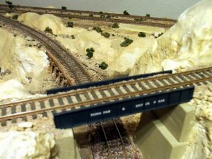

Here are 3 photos on my Tonapah and Silver Peak RR that I used crumpled news print and plaster cloth to make the scenery.
