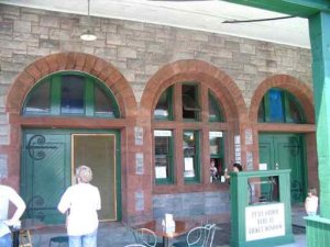

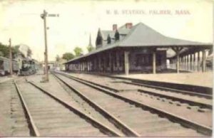

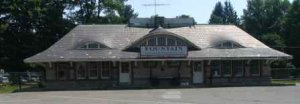

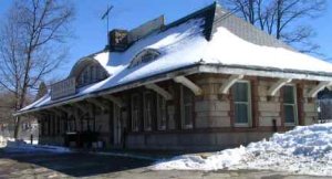

What a pretty little depot. Just out of curiousity, does that station happen to be located on old Boston and Maine ROW? The design, although different, is similar to some others I have seen around the Springfield area. Mainly the light colored granite with the brownstone window frames and door jambs.
60103 has a good plan there too. However, getting a good straight-on shot can be almost impossible due to natural or manmade obsticles. It never fails that with another 10 steps back you can get everything in, but unless you can walk through walls, fly, or dodge traffic while taking the pic, you end up having to take multiple shots, which never seem to line up quite right.
Here's a few shots of the stations I was talking about. However, the one you have is exceptionally interesting.
