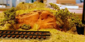

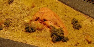

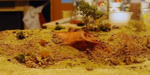

Many of the pictures I have from the area have too much variety between them in terms of color balance and style – your factual info helped a lot. Armed with it and some new photos from the area and a bit of resolve I went and started repainting the rocks. Here are some pictures of the first three redone rocks... I think this is a good improvement. What do you and the rest of the gang think?

I don’t know what the real rocks in the area you model look like, but your rocks look much better to me now (even though I think the white balance of your camera could still be improved). Good job.
N
nachoman
The color looks much better. You can "highlight" the rocks by taking some of the same color, adding white, and "drybrushing" the surface to make the features stand out. Drybrushing means putting a small amount of paint on a brush, wiping most of it off on a paper towel, then rubbing it along the surface. The minimal paint left on the brush will only rub off on the raised areas. This technique can really help details and textures stand out - makes it look like sunlight is hitting them.

Grandpa: I'll echo what Kurt said. I'm not familiar with the area, but the original red was unbelievable; it looked more like a ruby-shelled bug caught in the plaster.
However, the camera doesn't always get it right. There used to be a ground foam which looked green in real life but yellow on film.

I think your doing great! The new color is much better along with the change you did with your camera. I travel interstate 40 (route 66) several times a year on my way to Texas and during the monsoonal times there is quiet a bit of green and lots of wild flowers also. I think your right on track here.
