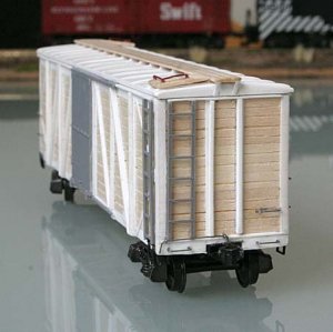

I’ll get the detail parts for the car tomorrow bounce7 .
I decided against removing the roofwalk before painting the car. I don’t want to glue the roofwalk to the roof when it is already painted. I don’t know how other modelers manage to glue painted parts without spoiling them, I can’t. Even if i carefully apply the glue with a toothpick, I mess it up. The best way for me is to assemble the car and paint it afterwards. Now that the roofwalk will stay on the roof, I added those supports to the ends of the roofwalk.

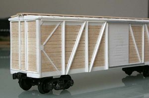

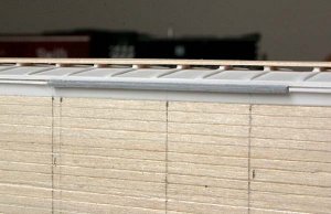

I got the detail parts today and couldn’wait to go on. I ordered Tichy’s wood box car doors (#3017). They don’t exactly match the doors of the DRGW prototype I try to model, because they need a lower door track. But I found a CP boxcar with these doors. And again, no rivet counting, I’ll mix the style of these two cars.

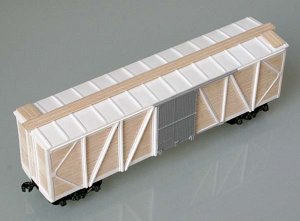

OK, here we go. First I cut the upper door track that comes with the doors to a length of 2". Then I glue it to the roof of the car.
cnw1961
Jan 8, 2006
846
Germany

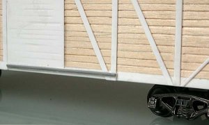

Next, I cut .080 x .012 strips and a piece of 1.22 x 1 x .012 styrene for the base of the braces and the door. In the next pic you can see it all glued in place.
cnw1961
Jan 8, 2006
846
Germany

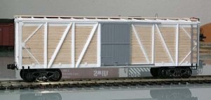

Now I assembled the lower door tracks. To adjust the height of the door tracks, I glued them to .020 styrene before assembling.
cnw1961
Jan 8, 2006
846
Germany

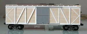

The next step is to add the braces. They are made of .040 x .040 styrene. Only the two braces on the right side of the doors have to be thinner (.040 x .020).
cnw1961
Jan 8, 2006
846
Germany
Before I added the doors, I glued pieces of .020 styrene to the backsides of the doors to make them fit perfectly under the upper door tracks. Et voilá, here it is, with all the braces and the doors in place.

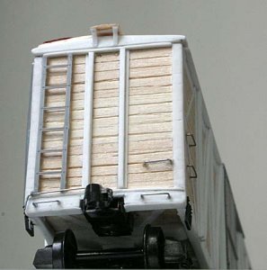

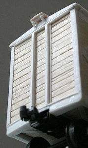

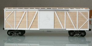

I spent the last two day adding details. I used .012 wire for the grab irons and the coupler cut bars. The ladders and stirrups are from Tichy’s. The next step will be to add the brake parts.
