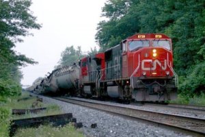

Yes, there's quite a mess in Prescott, Ont. Everyone was very lucky that the train had just finishing unloading at Maitland, Ont not 10 minutes before so it was empty when the cars left the rails. And extemely lucky that nobody was near the tracks when the train rolle over.
The train is a special unit train that shuttles diesel fuel between the Ultramar refinery in Quebec City and their fuel depot in Maitland, Ont. This photo was taken at the east end of the derailment. He was extemely fortunate to be able to take this photo as the whole site is now completely closed off.

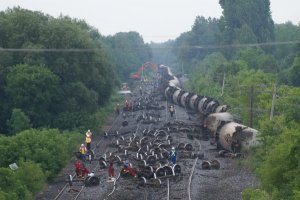

Here's another shot of the derailment taken by another friend. The train started to leave the tracks just at the bottom of the photo. The track on the left is a passing track. This has been extended and is being used to route freight trains around the derailment. The two tracks that you see torn up are CN's double-tracked mainline.

Wow - what a disaster!!! Although it could have been far worse had those tanks been filled with deiself fuel. Those tracks sure are bent out of shape, and it looks like the wheels just "unzipped" from the train.
When I saw the photo above, the first comment that came to mind was "look at all those metal wheelsets!"

Another visit to Prescott yesterday afternoon and you would never had known there had been this big derailment. All of the tank cars and equipment had gone. No side-booms, ballast tampers, bulldozers, wrecking crew. No nothing. Except for two things - but you had to look hard to notice them.
On the south side of the right of way were a whole bunch of wheelsets and ties bulldozed back into the ditch. You had to look real close to see them.
The cause of the derailment, according to CN, was a sun kink in the rail. Having visited the site Tuesday evening, you could definitely see that there was a sharp kink in the track which seemed to shift the whole track over by about 6". Those top-heavy tank cars, taking that kink at 60 mph would definitely have started rocking in unison and tipped over, because of their high centre of gravity.
I guess at some time in the near future, CN will replace the short sections of rail installed on the panel track with some continuous welded rail.
All in all, a job extremely well done by CN and their contractors.

They had just finished unloading diesel fuel at the Ultramar storage facility in Maitland, Ont, about 5 miles up the track. The train was travelling at about 60 mph when the cars started to roll. The grade is all downhill so they were travelling at quite a clip. The drop in elevation is quite substantial.

I lived near here when it happened.
1) The track on the left IS NOT a passing track, it is whats left of the lead that was there when the CPR had a connection from a line they used to have to Prescott to get into the CN industrial spurs there. It is now ONLY used for work trains and the Brockville local to use when they are switching if they CANNOT occupy the main line when completing their work. They did end up putting a switch at the other end to route trains over its 50lb rail. That switch is now gone.
2) The kink was a malfunction, that was all new track that was recenlty redone. The crew took shortcuts, it was found that the foreman took shortcuts before. And I heard from an unnoficial source that he and some of his section crew were fired.
