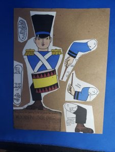

1st I printed the design on label paper and affixed it to some heavy cardstock.

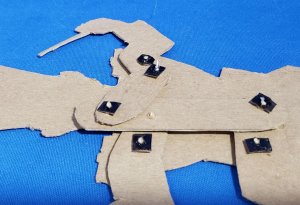

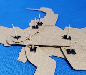

The pins were mad by pushing a toothpick through the lower of the two parts of the assembly cuttings them of flush on the front side and gluing.

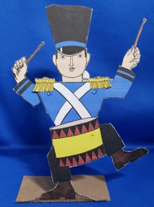

You move his leg to make him play the drum
Next was making a large enough hole in the moving part for it to move freely then capping it with a small cardstock fastener and gluing in place, careful not to make the cap to large that it could block movement and not over glued so it couldn't move. W20200716_183654.jpg20200722_145941.jpghen dry cut off the remaining length of toothpick.

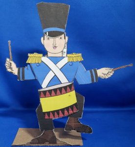

This would be a fairly good starter build for anyone looking for something simple and fun 20200722_150205.jpg20200722_150013.jpg20200722_150026.jpg
