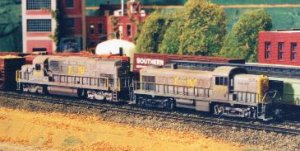

:( Is it just me? There seems to be next to no L&N factory paint jobs out there in N-Scale, the same applies to Alco's (other than RS's). Don't seem to be many Sou, Atlantic, Seaboard, Cotton Belt etc. either. Why do the manufactures ignore the Alco C series (both 4- axle and 6) and most of the south and mid-atlantic roadnames. Below is an RS-3 and C-400 but I had to paint em' myself and the C-400 is a model power shell on a Atlas B23-7 mech. Com'on Alas and Kato get with it!:mad: ( yes I know there are some PA's out there but I'm talking freight).

Catt, first get 2 body shells as things like the steps tend to break easy. There are a few knobs on the inside of the roof of the body shell that need to be removed. The oiler line(I'm guessing at that's what they are) on the trucks on one end had to be removed to clear the steps on tight curves. Then a fair amount of grinding on the metal frame of the mech. on each end so the body would slip over it. All in all it's not that bad(can't be if I can do it :D ), just ticks me off these loco's are completely ignored by Atlas and Kato. When you get done the biggest thing that is noticeable is the Model Power shell has oversized steps and handrails.

Tyson,
It looks like you've done some really fine work with those engines!
I, at one time, not too long ago, had this pipe dream of building an N scale version of the L&N's Cumberland Valley Div.
I wanted it to be in the early 60's, so I could use as many as 5 paint schemes on the engines, & have both the newer bay window cabeese, & the old "woodies".
But alas, one more big scheme of mine that never got off the ground. (yet...;) )
That is one thing that I love about the early 60's L&N, was that wonderful hodge podge of 1st, & 2nd generation diesels that you would see lashed together, sometimes 6 or 8 to a consist, & always plenty of Alco's, belching that black smoke...
Ahhhhh...just the thought of all those diesel fumes brings a tear to my eye, & a lump in my throat...:D
BTW - The weathering on those Alco's is really fine!
They look like the real McCoy!
