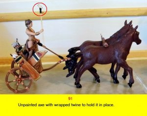

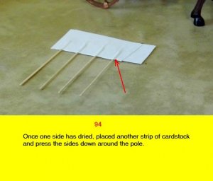

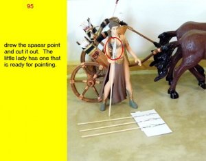

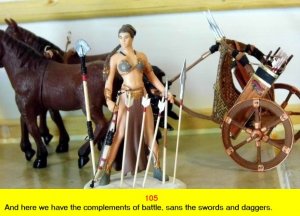

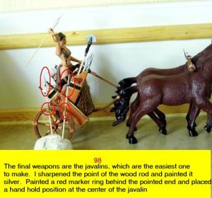

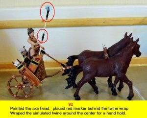

Still working on the Chariot. Here the photos on the making of the axe, spears.

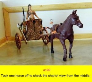

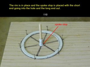

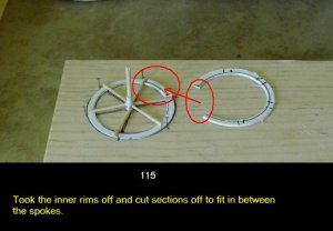

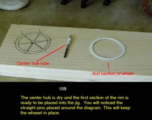

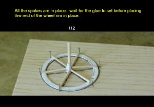

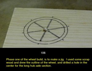

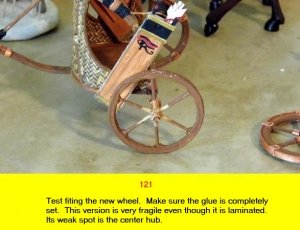

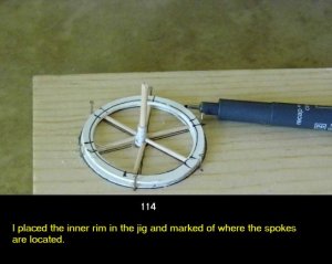

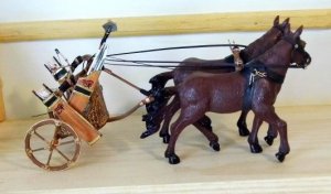

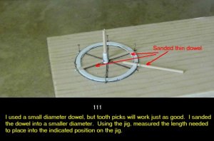

I redid the wheels and they look much different from the ones previously done. The metal hubs were re-painted that gold/bronze color and later on I will do another wheel tutorial. In the meantime, here is the next batch of photos.
Well I am getting to the end of the chariot build and then on to the harness, but I do have another treat for you all. Another remake of the wheel construction which I will incorporated later on in my coach threads. Enjoy and see you all next posting.

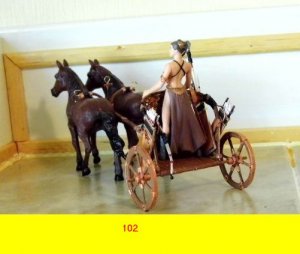

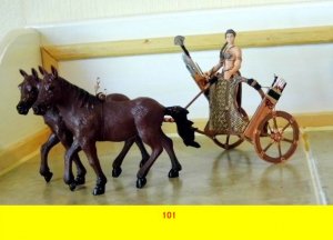

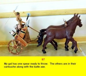

So on with the show and here are the last of the chariot build, and next the third version of making a wheel followed by the harness build. Enjoy and see you all soon.

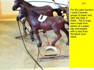

So again, here are the next batch of photos. The harness is coming along very well. The halter and reins are finished and I am working on the chest straps, but that will be for another posting. Enjoy and see you all next posting.

Well the chariot and the horse team are finished. I just have to edit photos and post them. Here are the next bevy of photos. Han Solo made a cameo appearance to check on his wife. Enjoy and see you all around the forums.

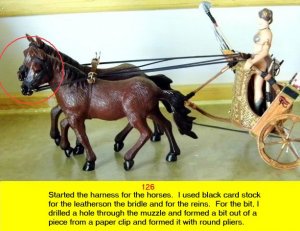

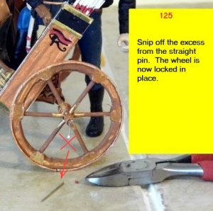

Well, the thread is almost coming to the end. The stand will be the last thing but I will make that out of wood. Started on the harness and it came out much better than I expected. Enjoy and I will see you all soon with the finished product. Princess Leia Organa will not be part of the display.

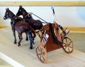

Hi Silveroxide:
A lot of work redoing the wheels, but very rewarding. They really look lighter.
You're really launched on this project. Everything is coming out very good.
Rgds
Carlos
There is another version for the making of the wheel incorporating some of the other methods but that will be for another thread.
Excellent work. You can always just cut a spacer with a diagonal cut and slip it on, but unless you plan on hooking it up to a Chihuahua and actually using it, why bother! The wheel tutorial is excellent and could be modified to work on about any wheel made. Great stuff!! :)
Thanks for the comment Zathros, There is another version as mentioned above

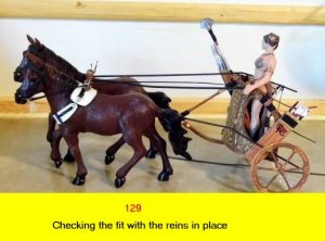

All things must come to an end and this thread is just about done, One more post with finished photos and and to the next project, the Storm Talon.
Enjoy the photos and see you next posting.

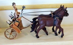

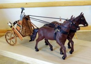

Finally the end is here. I hope that you all have enjoyed the thread as much as I did in making it. Now to work on something else, but I will be back to the horse drawn subject soon, but something different for now.
