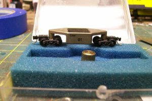

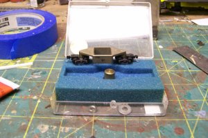

Here's a couple of pics. Of course, the Handi-Wipes have been all used up. And I tried to dry transfer reporting marks on it for my line. They should come right of.
