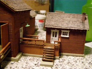

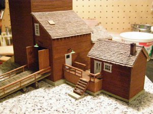

Campbell Scale Models M.E. Nelson Livestock Company is a really nice wood kit. It sells for around $70.00. You can also get cattle loading pens and stockpens with double shutes. I have built some campbell kits and the quality is excellent. I haven't built the stockpens but have seen it built and it looks great. Here is a sample of one of their kits I just finished building. Ron
