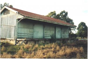

Goods Shed
The goods shed is EXACTLY this. Right to scale. Note the supports holding the verandah up, the air vents, pipes, the "bash" boards etc and the platform are all part of the model. DO US/Canadian models, use exact prototypes like some models here do?
