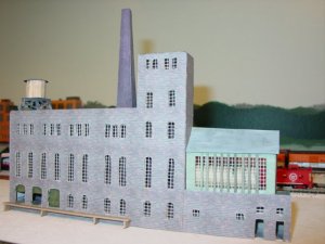

I started to do a "how I do windows in my cardboard structures" for this project but as I got more involved in it I forgot to take the photos to go along with it. So I will try again on the next one.
This structure was a bit of a challenge as it has 6 and 10 ft windows that have an arch at the top. I took most of last week and 2 days this week to do it. I made the support for the water tank out of individual pieces of my business cards and the chimney is made out of the "invitation stock" The basic building is from the cardboard back of a paper tablet. It is patterned after the Heljan "Brewery Malt House" kit that I found in the latest Walthers THS mailer.
It took me more that a week to get all the windows cut and the arches done right.
I am calling this building "Tyson's Malt Products" and placing it in the background with the Matthyro Freight building. I am going to have a pretty large "Gauge industrial area before long:) :) :)

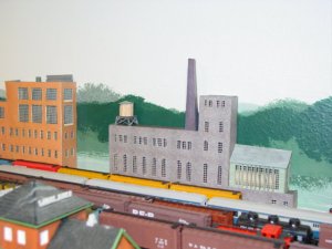

and here it is placed next to the Mattyhro Freight building. A cut of Blatz beer refers have already found it and are sitting in front of the loading doors. I need to talk to Errol about his shipments of "malt" and "malt products".:) :) :)

Very nice David. How did you cut the curve in those windows. I have tried doing that and found it difficult. A busy looking structure that is a great addition to your railroad. Thanks for naming your freight building after me. It's fun using names from the Gauge as much as I do using NARA members names
Thanks Robin. I have been following your coal loader thread and am very impressed with your detail work.
I did the curves a couple of ways. (1) cutting them with the xacto blade was unreasonably difficult so I gave that up. (2) I cut the windows up to the arch with a rectangle cut and then used a round file in my cordless drill to file the arch. (3) same as 2 on the cut then I used a half-round hobby file to make the arch.
I could not hold the piece steady enough for the drill & file option to work accurately. Wasted a piece of cardboard learning that. the hobby file method was the one that worked best. Took a little time but it gave a rather consistant arch I believe.
