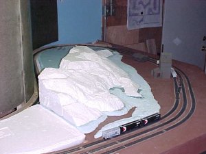

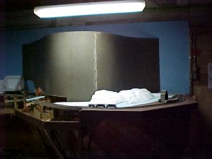

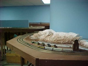

I spent some time this afternoon working on the layout. I have redone the backdrop around the Enterprise operator pit so a little more of the track is visible behind Telocaset. I'm starting to try to get some of the scenery started in the area also. It's too early yet to say how it all will turn out, but here are a couple of pictures to give you the impression that something is being done.

That looks like a great project you've got going there, upguy!
Looking forward to seeing more!

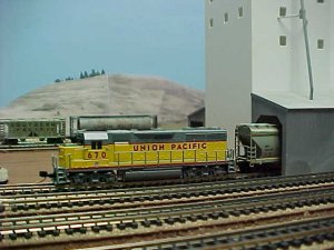

Are you insulating both of your rails on your turn outs? I dont want to sound out of line but I've always thought that the common rail didn't need to be insulated. or is this for DCC,which I haven't gotten into yet and haven't a clue to what gets insulated.

Shane,
I have insulated both rails between the main lines because that is a requirement of Ntrak modules, which many sections of my layout were originally planned to be.
It is my understanding that it is better to not use common rail wiring practices on DCC equiped layouts. I do have the layout wired for DCC, but double insulated tracks are not necessary for it. In fact, it would probably be better to not have the tracks insulated at all. However, I will have a way to connect all the tracks electrically--probably by feeder wires that will be routed through toggle switches of some sort. (I don't have all that figured out yet.)
Presently, the track is powered through rail joiners and widely spaced feeders wired from buses which run under the layout. The spacing between the feeder wires will be reduced as I get the time, which will also reduce the need to depend upon the rail joiners for a good connection. Hope that helps your understanding of my wiring.

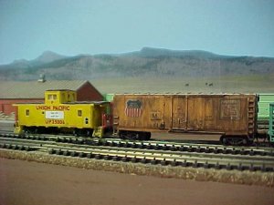

Here's a picture taken at Union, Oregon, on the layout

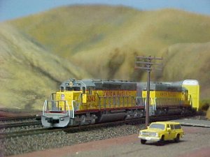

Here is a picture that I took today.

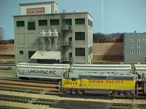

Here is a recent picture of the Telocaset module (where most of the scenery work has been done to this point).
