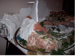

I am make one night now of the royale gorge. This was a very ineresting line. It went to leadville and grand junction. Now it is mostly a sightseeniging line. The gorge is over 1000 feet deep so obviously I am not scale. Scale would be over six feet. At the top of the gorge is the highest suspention bridge. Eventually it will be built up to 3 feet high. The gorge goes quite a bit back in my layout so youcan get that feeling like the train in the canon like loud music was talking about
