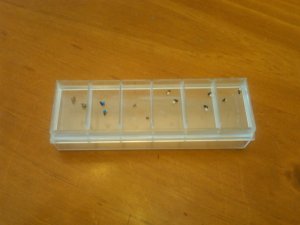

My wife hates it when I do things like that. She jumped a good 2 feet or so and accused me of being a sadist. And for the life of me, I cannot figure out why I kept the amputated leg s, but... well, here they are...

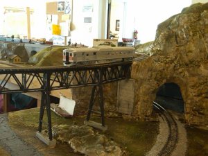

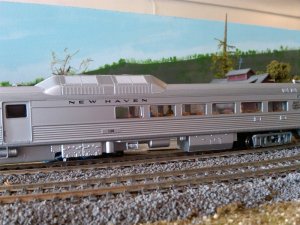

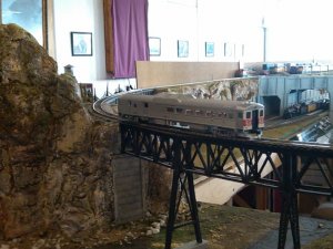

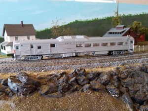

The next day, I took the RDC over to the club and ran it around...
