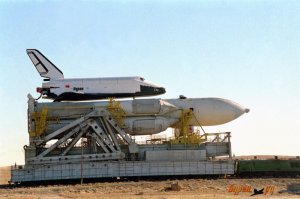

This is the Buran/Energia, mounted on the Grasshopper transporter. It required four locomotives to move from the assembly bldg. to the launch pad.

One thing I'm a little confused about, there are many photos of Buran/Energia on Grasshopper, in some pics the Grasshopper is green and some it's battleship grey. I know there are two Grasshoppers, both are grey (and rust) now. The grasshoppers were originally built for the Moon Rocket, and reconfigured for Buran. They were green during the Moon Rocket program, so I assume it was green during the test fittings, and painted grey before the real flight. Personally I like grey, but I want it in whatever color it was on the day of the real flight. I made a few inquiries to Russian aerospace companies, but got no reply (maybe because I wrote in English?). Anyone have any information about this?
You may have more knowledge than anyone I know of. I like the grey also. Green never looks right on models for some reason, to me anyways. Maybe it was a zinc chromate primer they used?

Update: Color question answered
I went to Youtube, and found there are lots of Buran videos. Most are of the launch, the landing, or the building collapse which destroyed the orbiter. But I found one which shows the transport to the pad and the Grasshopper standing up. At the time of the launch, the Grasshopper was grey, so that's what the model will be.
My goal is to make my Grasshopper able to stand up or recline. The really difficult part is determining how all those hydraulic rams work together with the girders to tilt the cradle. Leo's transporter has a hydraulic ram, which I downloaded and built so I could understand how it works.
Leo kindly gave me permission to copy his rail trucks for my Grasshopper. It makes sense to do this, since it's the same launch facility and the same approximate time period, so they are going to be very similar, if not identical. The Grasshopper has 32 rail wheel trucks, with 4 wheels each.
