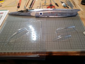

The only thing that stops me is that I find hard to understand what kind of products should I search to make the master. I'm sure I cannot find here the same products you used (available in Germany), but if here is something similar I'm not sure what should I look for.
Any advice?

Well the so called "Feinspachtel" is something like fine putty. You can use gypsum or plaster with a fine struture as well. Putty here in germany is available in different porosities. Use the finest putty you can get. If you are not satisfied with the surface you can use some spray primer and sanding to flatten the surface.

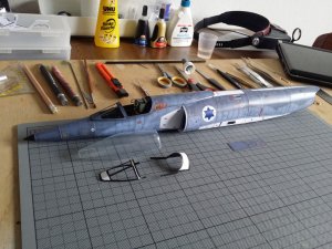

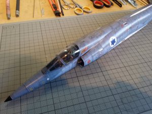

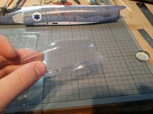

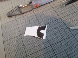

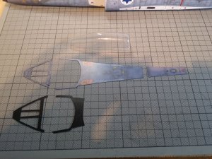

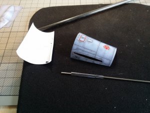

A tiny update on the Kfir. The canopy frame has been cut out and the edges are colores plus the parts are bent to the almost final shape. The Canopy Frame on the fuse has just been placed there to check the fit... Going to Munich this weekend to meet some old friends so the next update will hopefully be on sunday

You can use two part epoxy two makes either negative or positive molds. If it is a positive mold, you heat a plastic sheet and pull inf tight over the plug of the canopy shape, and cut off the excess when it cools. If a negative mold, you can drill small holes, and make a vacuum chamber using a heat gun and vacuum source. Old refrigerator motors, especially the small ones, give great suction.

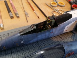

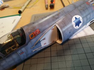

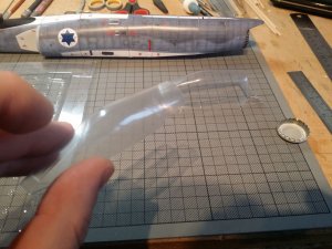

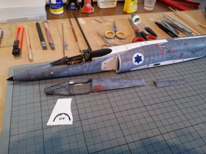

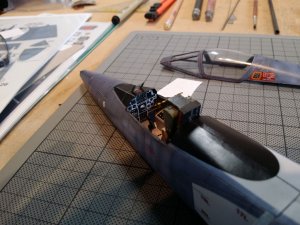

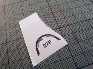

Some small progress has been made.

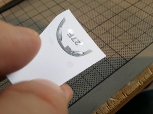

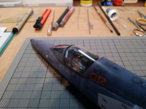

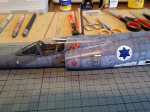

I just finished the canopy section of the Kfir. Glue is drying now. While the framework on the canopy dried I tried to add a bit realism to the mirrors. I took overheadprojector foil, cutted out the mirrors and glued them to the framepart. The part got also colored from the backside to keep that nasty white blinks away ;) I think it looks good so far though I wonder if you can see it when the canopy is on the model... But it is as always... I built it and I know it is there
The HUD is in place and ready to operate
Next step is to trim the canopyframe properly and glue the part in place so the cockpit is finished.

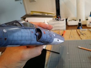

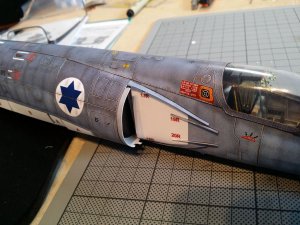

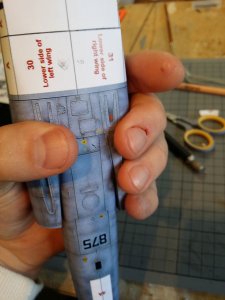

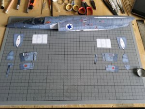

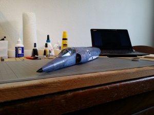

Today I built the intakes and mounted them to the model. As Yoav said it was a bit fiddly to attach the intakes to the model but nothing severe
Only things I had to trim were the shock cones a bit when assembling the intakes itselves and of course adding the slots to the fuselage itself for the splitter plates and the gun covers at the inside of the intake.
Again the beauty grows. Only thing I am not so happy with is the slight gap at the auxiliary air intakes between the splitter plates and the fuselage.
Well... next time
At the moment it looks good to me... There is always room for improvement I think
On the detail pictures you can see how I bent the gun covers and the special "McTschegsn grab" to let glue dry when mounting the intakes
