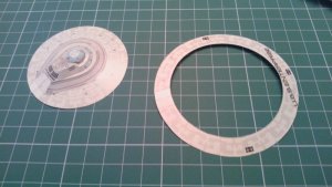

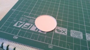

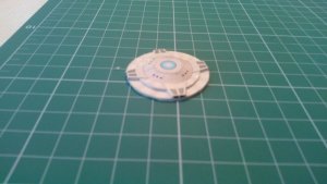

This is my second attempt to build the 2009 Enterprise by Uhu02 :inw:. The first time I tried, I was a "freshman" in this wonderful hobby, and thought it wouldn't be much hard. Boy, was I wrong!
Now, after I've got proper tools and assembled some other models, ending with Julius Perdana's Iron Man (it'll never cease to amaze me!), I have decided to give that model :inw: a try. I have to.
And I will also try to build Ron Caudillo's magnificent TOS Enterprise next, whatever the outcome of this trial is. So, let me present my first two pictures of my (not so good) attempt. And a heads-up: I have not used any tabs (I will, though, for the internal formers, or reinforcements, whatever their name is).
Let's not forget that Uhu02 :inw: has a detailed step-by-step assembly of his model in his site...:mrgreen:

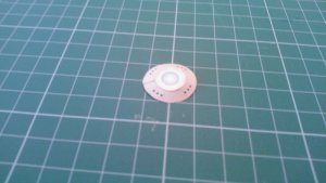

That's it for today

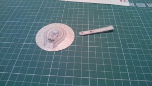

Well folks, I must say that I thought I could do better, although I'm still satisfied with it. This model is as fantastic as difficult, but, I as usually say, DIFFICULT IS NOT IMPOSSIBLE!
Micahrogers
Maybe I didn't get you straight: isn't there a photo that shows a piece in separate, already cut, but not yet glued? If there's none like that, please tell me what you need, and I'll try to provide it. If you need details, please P.M. me.
Thanks!

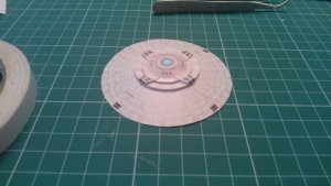

Good morning!
Good morning and nice Saturday!

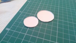

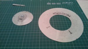

Here in Rio it's warm and cloudy, what increases the warmth! I started to work on the lower part of the saucer... This is where things gone terribly wrong in the first time, so CROSS YOUR FINGERS AND HOLD YOUR BREATHS!sign1
Here are some before-and-after pictures. I had to butt-join the two pieces, and did not tape it.
It sounds obvious, but the best way I found to do this is by sectors of 30-70 degrees, one at a time. Check it out.

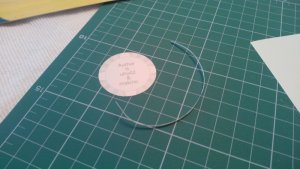

Now both...
Here both circular parts of the lower saucer with their "strips" glued. I found out that sometimes, because of cutting errors, the strip is longer that the circular part's length. It forms a small, undesirable ripple.:eek:
I was able to hide it in the bigger one, but in the smaller... NO! So what did I do? Simply cut the excess, and hide the seam under the piece that will fit in on top of it (check pieces number 24).
Here are the pics. I'll show the assembly on the next one. Looking kinda sloppy, I know, but it's in my tolerance range.:p

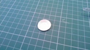

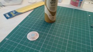

Went on assembling, and when I tried to glue the last sets together, the smaller collapsed. AAAARRRGGGGGGHHHHHHH:curse::curse::curse:. I though it was strong enough, for I had even taped the seam, but noooo....
But I was able to revert it all. That's why you'll see the small hairpray can. Didn't figure it out yet? Then take a look at this: http://www.zealot.com/forum/showthread.php?t=173778
And the pic...

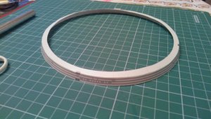

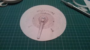

Progress so far
This is my progress so far. I went past this phase on my first time, but this is looking way better (OK, it' not so good, but it's still fine by me).
Rogerio Silva
Nov 10, 2012
1,523
11
38
Rio de Janeiro - BRAZIL !!!
Started the lower part...
Now, from the bottom up...:thumb: Taped the seam of the first section above the sensor array (first picture).

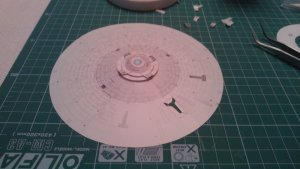

Now I think I've got it!
Hello and thanks for visiting!
This is the first time that I ever got really happy with my work on this hobby. I think I found a way to do some good "butt-join", or "edge-glueing", and I would like to present my results. There were two long pieces that need butt-joining, and I did it fairly well for a newbie.
Let me first talk abot this (obvious) technique, it's absolutely simple: just put one of the pieces in a long surface (I used my cutting mat), spread some glue along the edge using a toothpick or something sharp (I used long, sharp twezeers), and then hold them together until the glue holds.
Simple AND obvious, but when you figure it out for yourself, it gives you a bit credit, doesn't it?:p
So, the picture shows the results. I'm happy!:thumb:
P.S. This isn't the time to get cocky!sign1
