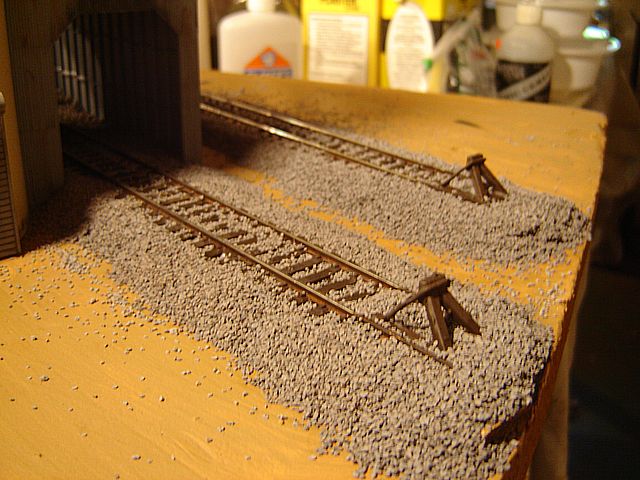

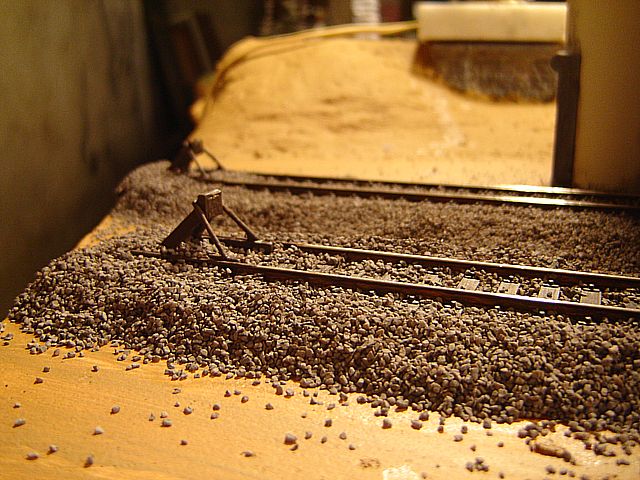

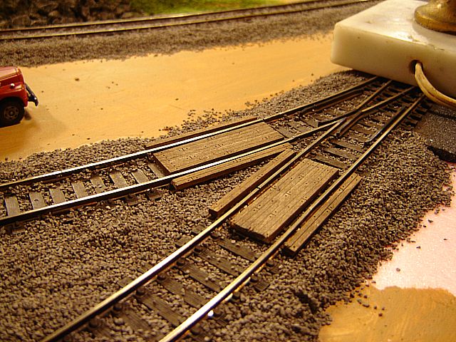

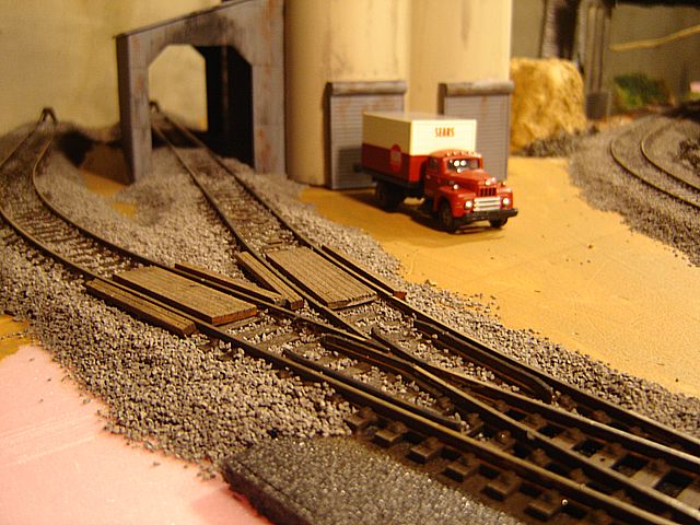

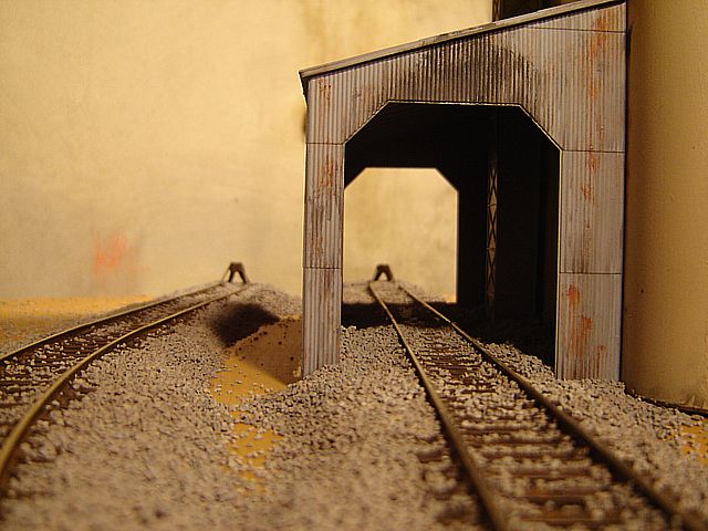

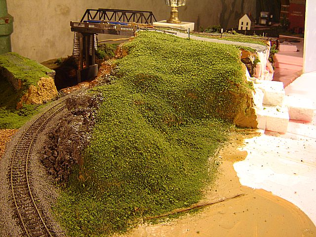

Now I finished the ballast around the track bumpers and around the shed.

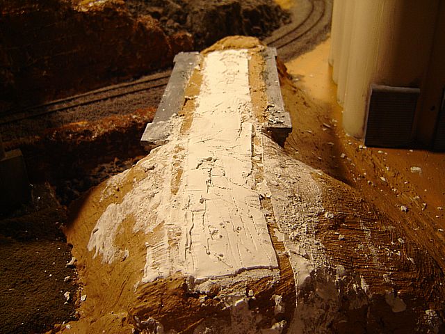

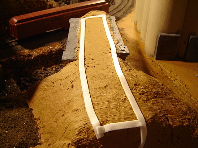

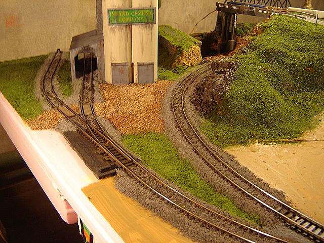

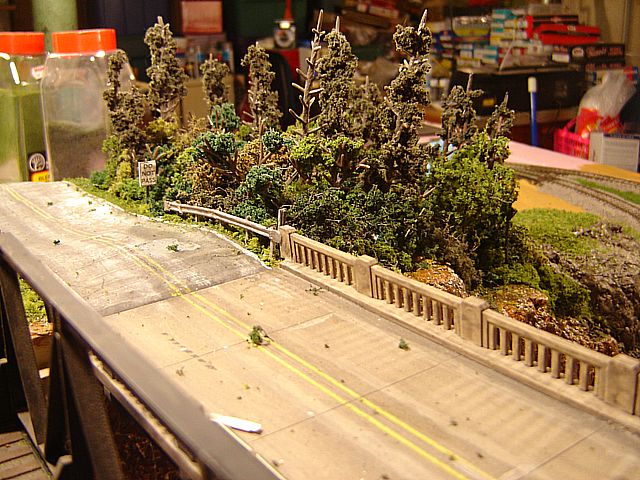

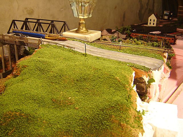

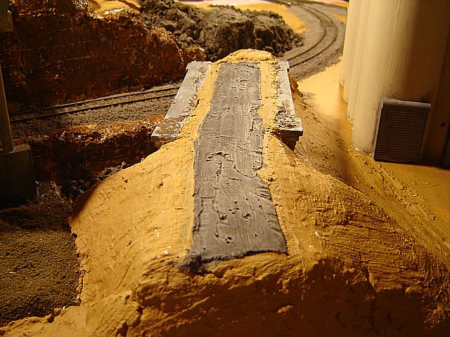

I now have begun the abandoned road. I am using Woodland Scenics Smooth-It to make the road. First I place the Paving Tape to outline the road.
I then fill in the area with the Smooth-It. Allow it to set and remove the tape. Next I took an Xacto knife and beat up the old road.

Thanks folks!

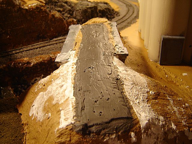

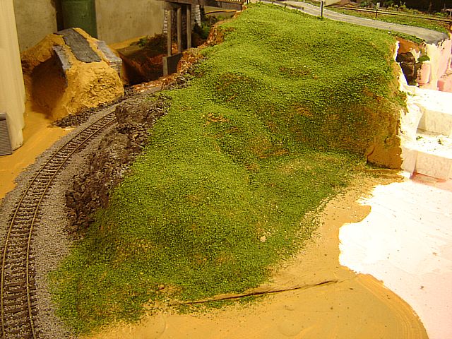

I painted the entire road with Folk Art Dark Gray.
Now I weathered the road by dry brushing Folk Art Charcoal Gray, and Light Gray. I then hit with a Licorice wash. I also touched up the areas that where the Smooth-It ran onto.

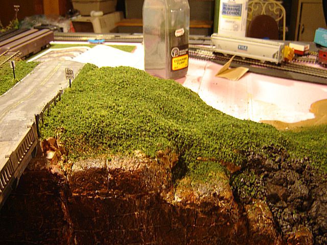

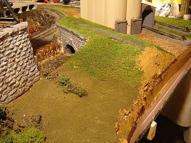

Terrific work!! Looks like those trains at the water tower will have a LOT more great places to go!!

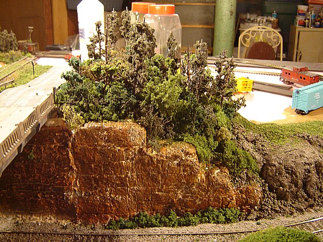

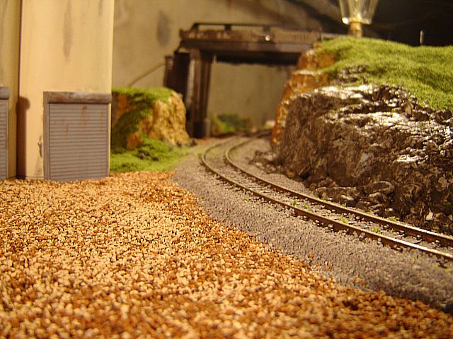

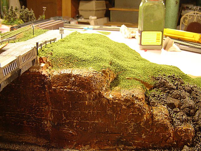

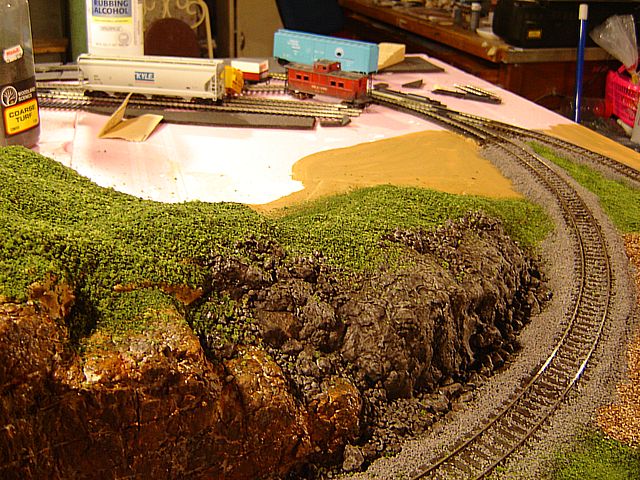

A question. The colors you apply to the rock faces, are they all washes?? It seems as if they had "transparency". I use some of the same colors you use, but mine look "painted", although I do dilute them quite a bit. How do you achieve this effect??
Also, do the acrylics hold good on plastic??
Keep up the good work!!
Gus (LC&P).

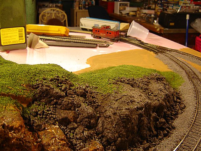

Thanks guys!
I use the paint straight out of the bottle. I use cosmetic sponges to apply the paint. I dab it onto the rock face. Some times I use a brush but again I dab. I do not "paint" the colors. When I apply the washes at the end I do use a brush and "paint" them on.
As far acrylics holding on plastic I found that you have to make sure you use a sealer. Also if the plastic is slick I will spray it will Dullcoat or gray auto primer from a spray can as a first coat.

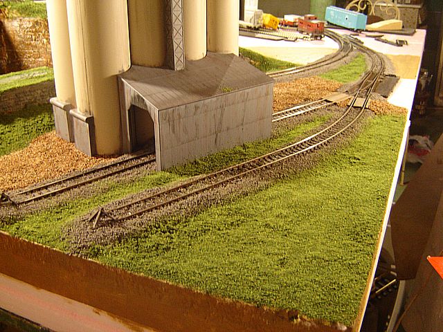

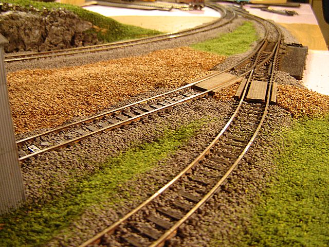

Hi,
Really looking good!! What's the gravel you're using?? Also, are the acrylics sprayable if thinned enough?

Thanks!
steamhead said:
Hi,

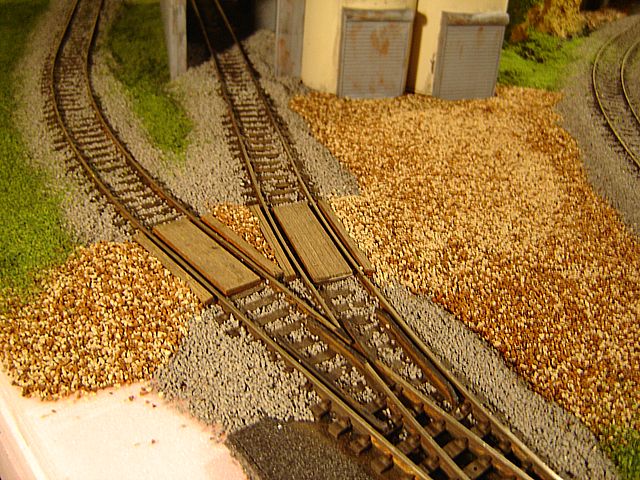

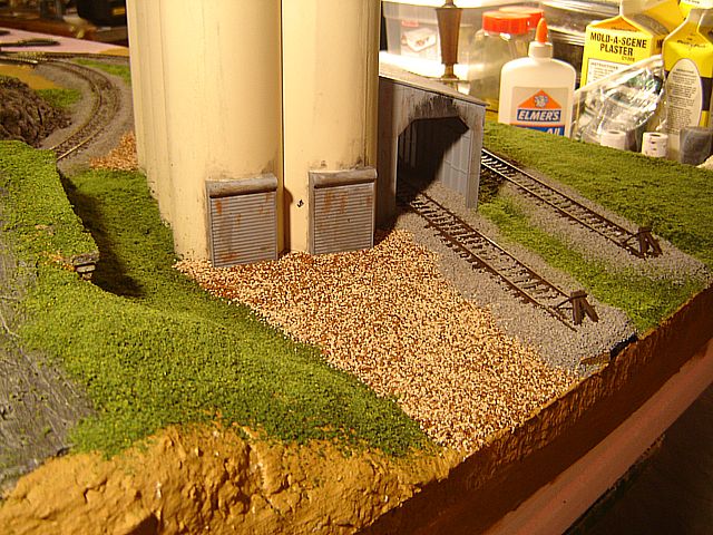

The gravel is Woodland Scenics Medium Buff and Medium Brown. I pour some of both in a cup and then shake the cup up to mix them. I then pour them were I need them.
The acrylics I use which are also called craft paints are sprayable. I dilute them at a rate of 1 to 1 with blue windshield washer fluid.
