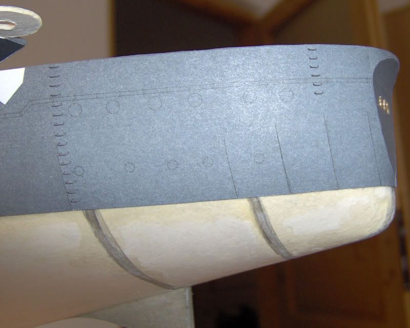

Whoa! That's got to be the smoothest hull I've seen on a card model. Nice work!
I'm with you on that. It's perhaps the most perfect formed hull in paper I have seen here without sanding and painting the skin. :thumb:

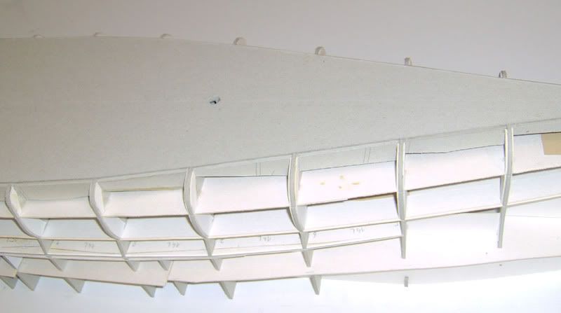

After long breake there is a progress:mrgreen:
Hull frames:

I noticed something, the number of longtitudinal hull formers seems to be more than the ones present in the kit? Is this your own modification? I also noticed that you have placed a large flat piece of cardboard at the bottom of the ship. This is also not in the instruction of the 1/200 Halinski Yamato.
Do you have a site where you got this technique or is this your own technique for a smooth hull?
I also have a 1/200 Halinski Yamato and noticed the difference between Halinski's by the book instructions and your technique of building and getting such a beautiful smooth hull. :thumb:
Yes, there is longtitudinal formers added under the board.
Yes, I designed this for flat part of the bottom, it gives very good result.
It's my idea to get a smooth hull, after seeing hulls filled with foam, I tryed to get a hull "paper only"
The very first try it was Akitsushima from Answer
modelarstwo kartonowe, plastikowe ... :: Zobacz temat - *[Relacja/Okrêt] Tender lotniczy Akitsushima 1:200 Answer
Thanks, I'm very happy that You like my work :mrgreen:

Thanks for the quick reply and the explanations! :thumb:
I hope that I can do your technique in one of my future builds to get a smooth hull with only paper and no foam or stuffing inside.
You're so good with your modifications. it's so impressive! :thumb:
Another question!
In the Akitsushima thread in the link you posted, aside from the formers, there are smaller formers added that are glued to the side of the hull formers.
Pic taken from the Akitsushima thread
In the first pic, you can see "kit formers" that are marked with the kit patterns and the gray ones which I assume are the ones that are smaller and to be glued beside the "Kit formers"
How did you measure as to what size/how small the "inner formers" are to be in your Yamato hull.
What patience you have to do these secondary formers! wow...:eek: :thumb:
