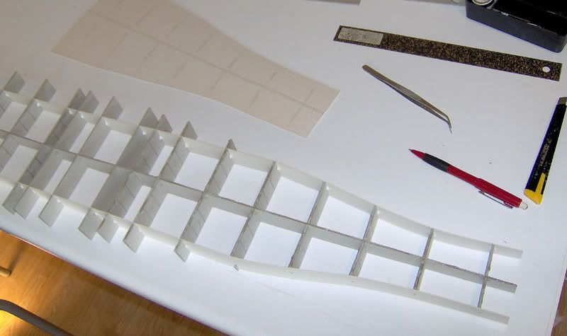

I'll try to show how I am building hull of Yamato - Halinski '04 in 1:200 scale. This is my second attempt to build one, the first was not good, twisted and with colapsed plating :cry: then crushed by accident :cry: :mad: .That's all I remaining.
I've started off with gluing the frames on 1m long, 12 cm large of 2 mm cardboard strips (belts?) and cut it out.
For flat part of the bottom I've designed a... 'subplating' :) large piece of 2 mm cardboard. Before that I cut out special gaps in the frames.
To get non twisted hull I made something I call 'the drydock' :grin: It's made from the rest (relic?) of frames cardboard. The pictures shows it better, than my inexpert explanation.
Why it's done for? It's going to be an exellent support for futur steps of build. The framing fixed to my 'drydock' won't be twisted (warped).
The framing is not yet glued.
To be continued.

Looks like you're doing a good job!.....just continue to keep weights on the glued parts of the hull while resting on a perfectly flat surface while she is drying...thats how I do it....but this forum has many other expert craftmen (not me!)...that may have other ways of doing it.....if you get the hull real straight and flat...you are well on the way to a really fine build....by the way this was the first lesson that I learned in card modeling while building the S.S. United States in 2000...had to rebuild it...and finally got it right on the forth build!!!...as my sainted dad always said..."experience is the best and dearest teacher"...Bob out:-D
