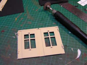

The window snap into position with these little interior posts. I am going to add an inner wall to this part so the first thing I have to do is get rid of the posts.

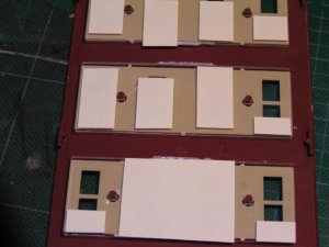

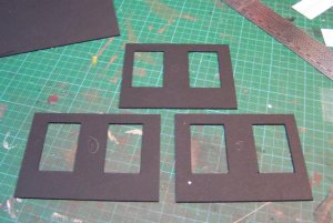

Using the same black cardstock as for the marine supply, I cut out these interior walls. The black will block any light leakage through the walls.
I scanned each piece first, then traced it in Illustrator. I printed the tracings and used them as a template for cutting the cardstock.

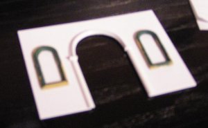

I also built a dividing wall between this section, which is a sitting area, and the back section which will be the main lobby. I created the arch myself out of sheet and strip styrene. The 2 niches on either side of the archway are leftover DPM windows with the mullions removed.
Sorry the first pic is so blurry. This is pre-paint. The second is after painting and installation.

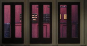

Okay, a lot of time was spent on the computer yesterday creating the back wall which will run the entire length of the lobby. The middle section is where the registration desk will go. Here's a reduced shot of the final that I have printed out.

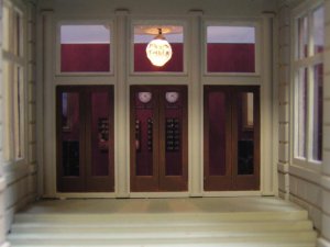

I've now added the back wall and registration desk. Here is a shot through the front doors. The only thing that's dimensional, beside the doors, is the desk. Everything else is done in Photoshop with drop shadows to create the illusion of depth.
The second photo is a close-up - I really like the way the pigeonholes turned out.

Awesome Val, the interior looks so real. Where did the carpet come from? I just love the interior details. Now where will this go on your layout? Has to be somewhere where we can get a peep inside.

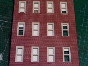

Doing the interior is making this project take a lot longer than it would otherwise, and especially since I am making it up as I go along. Today I tackled the repetitive task of of spackling the brick walls and adding windows and shades.
Here's 2 shots, one from the front and the other from the back. The interior will be lit, but in order to prevent people from seeing into this part, I will only light the windows where the shades are drawn. I've tested this paper and when lit from behind has a nice warm glow. I will block off the unlighted windows with more black cardstock.

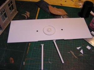

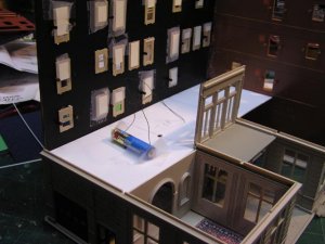

I made the ceiling for the lobby today - it will actually be partially visible, which I wasn't counting on, so I had to make some moldings for where the main chandelier will go. The first photo shows the "rosette" I made out of some strip styrene and a button. You can also see the pillars I've made out of styrene tube that will go in the lobby. The 2 holes in the ceiling are to fit the pillars through. It will be easier that way I think to get them straight.

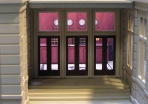

The second shot show my jury-rigged power supply to test one of the lights I'm thinking of using - a little N-scale grain of rice inside a plastic bead. I'm going to test it for 1/2 an hour to make sure there's not too much heat build-up.
The third shot is the light as seen through the front doors.
That's it for now.
Val
