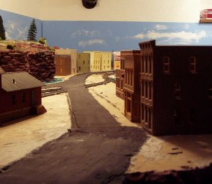

Hi Guys been laid up for a while and will be for about 6 more weeks. with a knee replacement.
We are over the pain barriers now.
I took some random shots before surgery, and hope to get back at it by November.

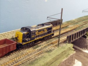

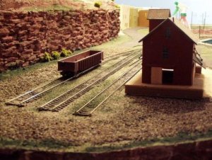

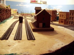

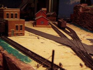

I have revamped the yard for traction (pulled the darn thing down ) and have just finished relaying the track.
I have to rewire the whole layout ready for DCC, but first I have to string all the overhead, and take out the blocks.

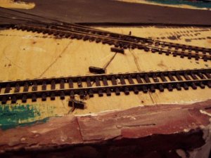

Here is the platform for my interurban small yard that I redid.
I have two tracks crossing the road I just finished.
Notice I did not use switch motors but installed extended manual throws.

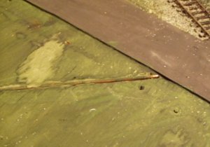

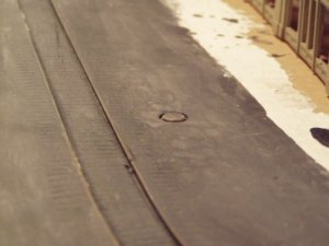

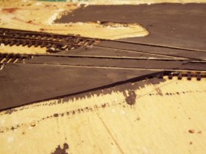

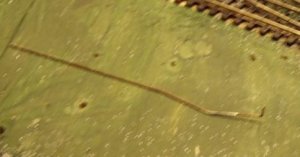

OK!.
One of the throws was really glued up after the scenery went in, after tugging it a bit the brass wire bent.
I did not want to undo the glue or lift the switch as part of that was in the road bed.
So improvise I must!
I usually bend the wire to fit in the hole where he switch motor pin would go.
Now I have to do it this way as the picture denotes.
I will in future only use steel 1/16th wire for this job.
Problem fixed in 5 minutes.

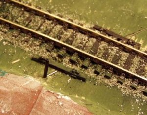

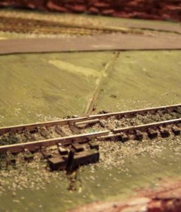

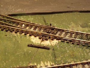

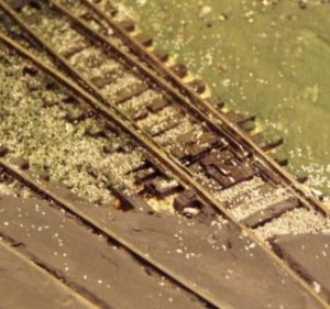

A closer look at the extended throw

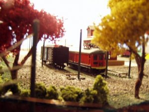

And a little bit of a start on scenery in this area.
Now then where did I store my trees?????sign1 sign1

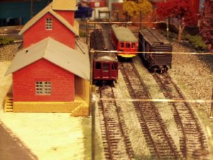

A liitle more work on this yard section .
With allowing for trolly pole operation and not just pantographs the over head is a lot slower to put up as every section has to be checked and double checked both ways, as trolly poles take no prisoners.
I have done a large section but here is just the yard.
