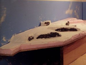

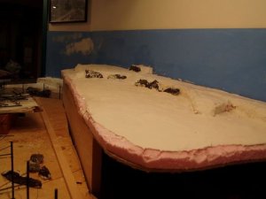

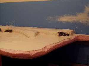

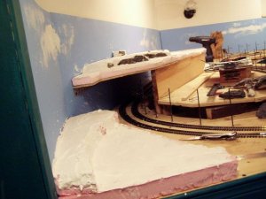

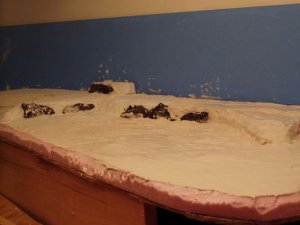

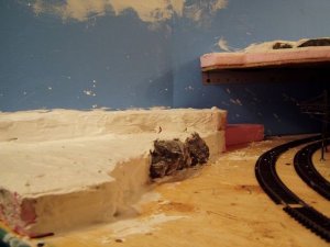

Hydrocal I hate it !
BUT I have to get this scenery in.

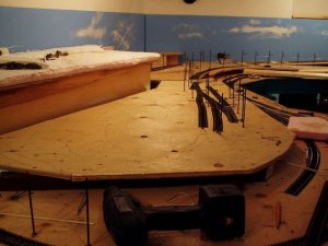

so here are a few pictures of my Laours.
I was given a box of cast rocks from Duckman as he has moved house last week.
so they will be shared and used by the gang.
This will be a main photo op area so I do hope I get it right.
Here are the basics.

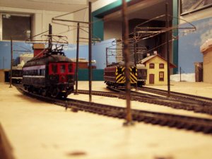

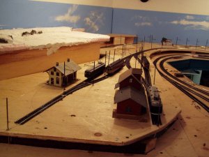

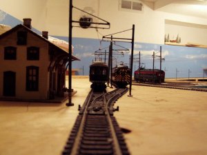

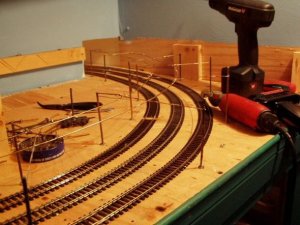

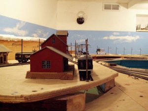

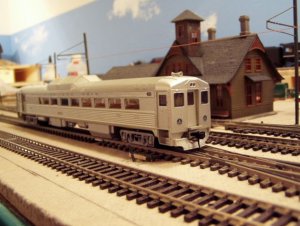

Its been a while but I am happy with this small yard its in and the overhead is up.
Scenery will follow after all the overhead is up and working.to my satisfaction.

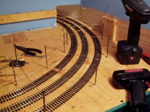

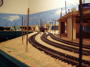

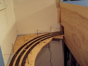

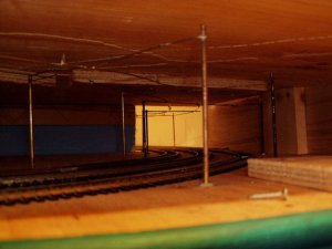

For those who are still viewing this thread, and are intrested in overhead.
I had a Christmas gift from an old friend for my L/O.
A Bud coach. the problem was that it being long in the body it was catching the poles that hold the wire up on the traction tracks under the high town.
So I had to take the town platform off and redo the poles.
So here is a chance to see the strong permant no maintance overhead I put in areas that are going to be out of reach.

Hey Chris,
Looks like you've been busy. I see that alot of your motors have pantagraphs, but I noticed one car that uses a pole. Does the one(s) ( I haven't seen your whole roster) with the pole track the hidden overhead ok? I can't tell what gage wire you used, but it looks fairly healthy, and forever.

zedob said:
Hey Chris,
Hi Zedob.
The overhead "wire" is 26 gauge phosphate bronze on all the exposed L/O
The heavy duty is only for "no mantinace or apperance" problems as it will be hidden , and that is 1/16th solid soft brass
The pole model is that of the Grand River Railway. I will be panning it soon when I have scratched built a couple more.
Each will have one pan and one pole, That is not prototipical of that road, BUT I only operate with pantagaphs.

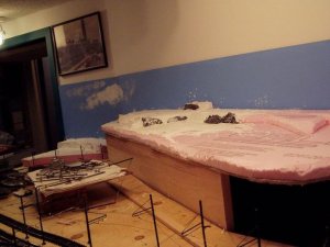

This week end apart from playing on ebay, I am better off as I was out bidded, boy they get stupid money for stuff eh?
Anyway I digest er digress

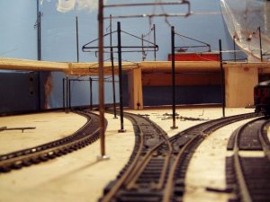

I did the hard part of my overhead, a lot of work in a small space, but it will make the L/O live.
What you will see here is,,, two overhead tracks one reversing on itself with 3 park ups at the station that will go there. The outside trackage carries steam/Diesel
I can now put the town platform back and continue with the rest of the overhead .
AS you saw the back hidden portion has very strong 1/16th overhead for problem free operation as I will not be able to see a wire adrift back there, and that would be costly

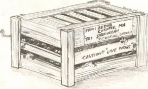

interurban said:
Thanks Bob and zedob, As jetrock said pole and Pan on the same unit was use by Sacramento Northern, I will have a few units equiped like that.
I have to find some way of getting frogs shipped up to me hhhhmmmm.
I have some questions about the frogs.
Do you need the overhead kind?
